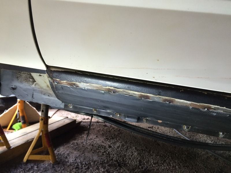

Blended the sill in very nicely with the old flap wheel on the grinder no need for filler with that finish well happy feeling more positive with how its coming together

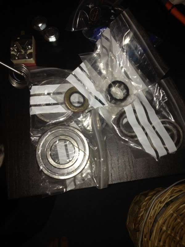

Ordered some more bits this month, Got 2 10" fans for the rad and a full gearbox rebuild kit as its still whining a little bit but the kit is only shy of £100 so not that bad.

My little pile of goodies

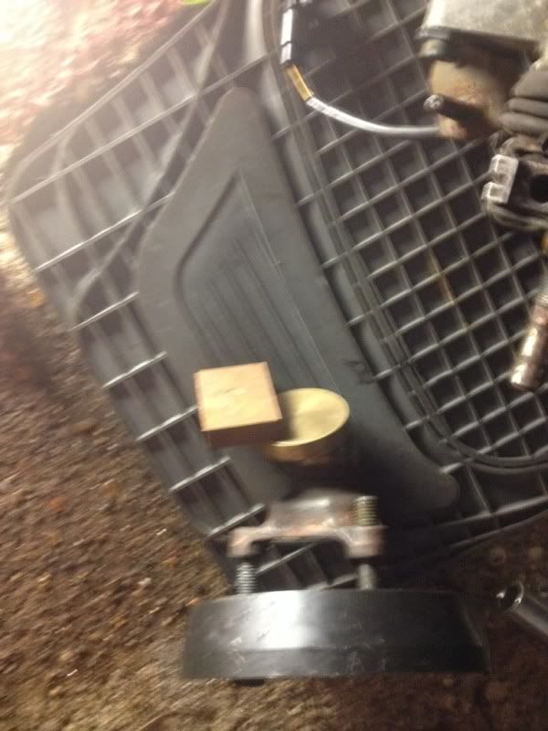

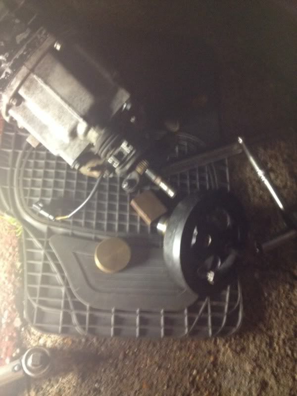

Started stripping the gearbox to rebuild it and found a nice little way to remove the rear prop spline by using the rear damper with a couple of spacers and 3 bolts tighten bolts then off she pops not on that tight either.
Crap images its dark lol.
Turboshed has lent me his large 46mm front nut remover but i need to modify it to pull the 2 halves apart.I have the hydraulic front nut which i can secure onto the tool by grub screws and then weld a nut on top of the tool with some threaded bar should do the trick.
don't know how to pull the 2 halves back together may use a little heat and put the input shaft in the freezer first.

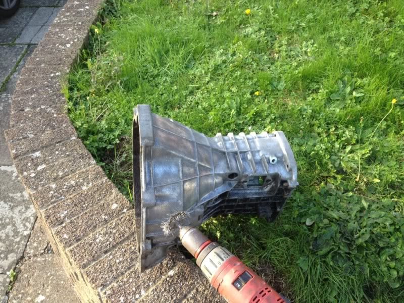

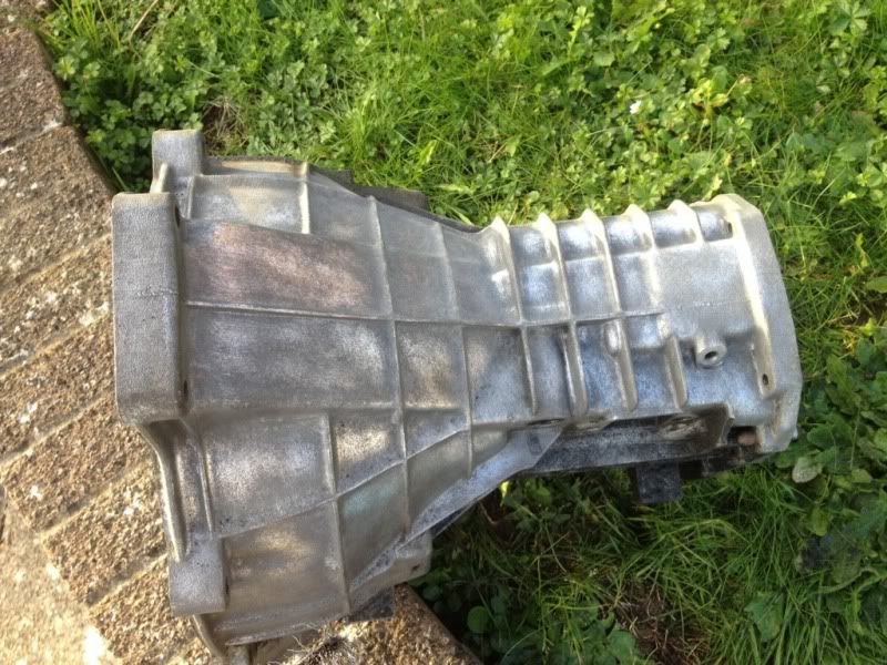

Picked up a second hand 4x4 mt75 for £25 on ebay for bits and decided to use the bell housing for my 2wd gearbox as the front of mine was black so out came the drill to give it a clean

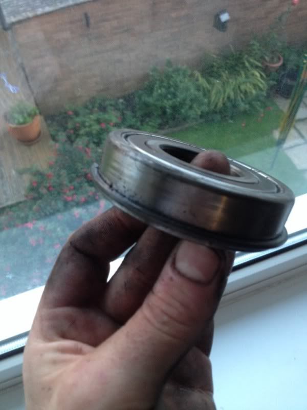

Im rebuilding the box as it had a slight whine to it which turned out that the bearing was cracked lol
Getting there with it now all this cleaning is driving me mad

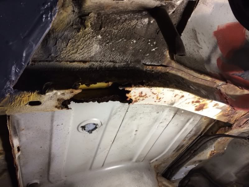

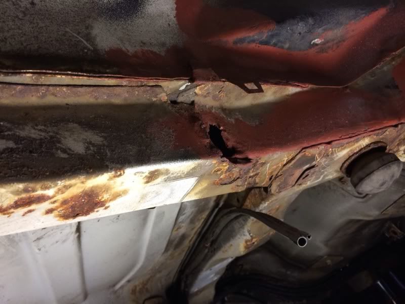

I have had another attack of welding this weekend which required the removal of the rear beam and fuel tank to weld the inner rear arch lips in and to cut all the rot out of the box section and finish off the rear end of the sills
That only leaves the front passenger side jacking point to be finished and no more welding !!!!

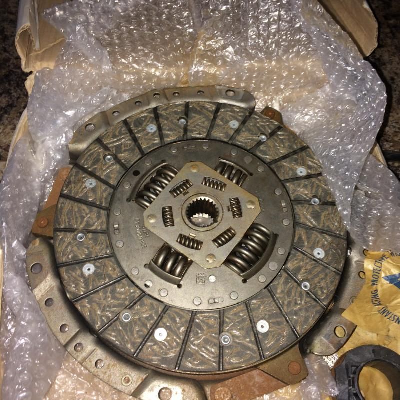

Been having a bit of a break from the car. But I'm back at it after I had no drive after refitting my rebuilt gearbox. Found the issue to be with the second hand ap cossie clutch I used as the centre female spline had separated causing no drive. My new clutch has been sourced and I have opted for a Sachs 2.5 Granada diesel unit at a price of £9.99 lol
All fitted and ready for the box to go back in next week.

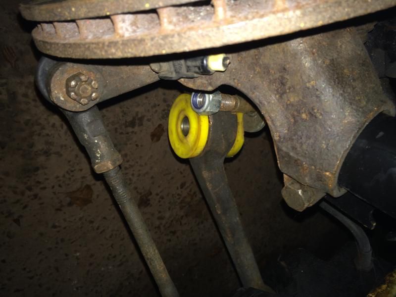

I have also poly bushed the front tcas

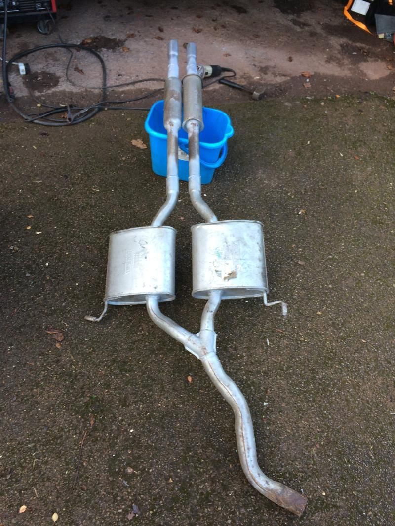

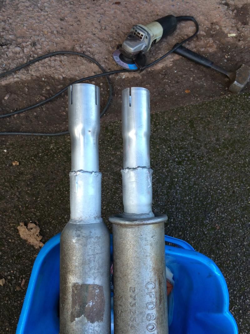

And adapted my exhaust as it was slightly too short when I made it before

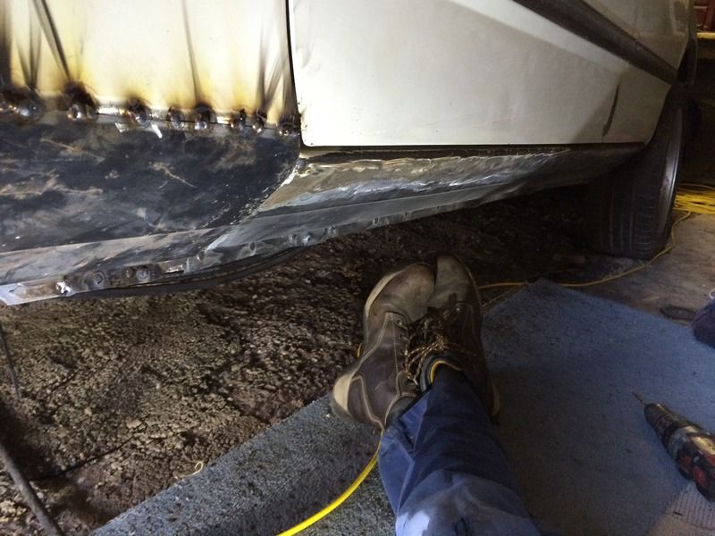

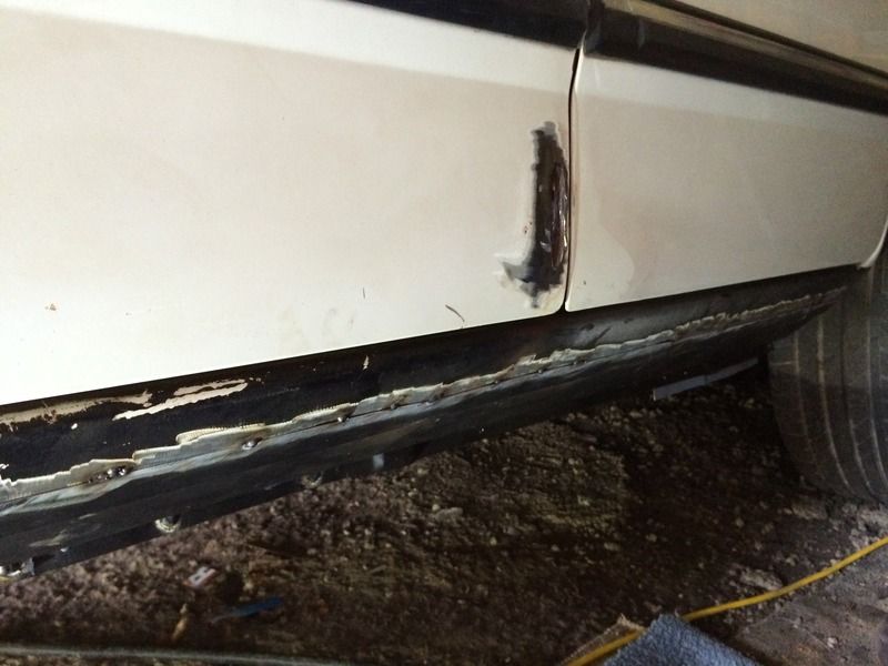

The bottom of the wings were rotten so rather than replace the whole wing i cut the bottom off another and welded that in and both sides job done.
I opted to weld this side sill on the front/flat face rather than like i did on the other side on the corner which makes it easy to blend with the grinder which = a lot less filler to blend so lesson learned.

Which way did you do the other sill - what do you mean?

MK22door i welded the first sill to the point where the door edges sort of join the sill this is curved so it is easier to grind the weld back and blend with the use of minimum filler. When i did the second sill i welded it on the side which on a flat edge is quite difficult to get spot on without filler and i found it more time consuming so you live and learn.

capri v8 driver
You actually needed one of these ( I dont know the name in English for it) :
You could make a edge on the metal so the new sill sits flat and there is no overlap. Its saves you a lot of work, grinding disks and filler.
They are not to expensive and you can get air powered ones to work even faster.
whiteestate
cheers i did see one and if i ever need to do sills again i will be getting one as it will give you more of a heatsink behind the weld which will also aid metal distortion with the heat.
