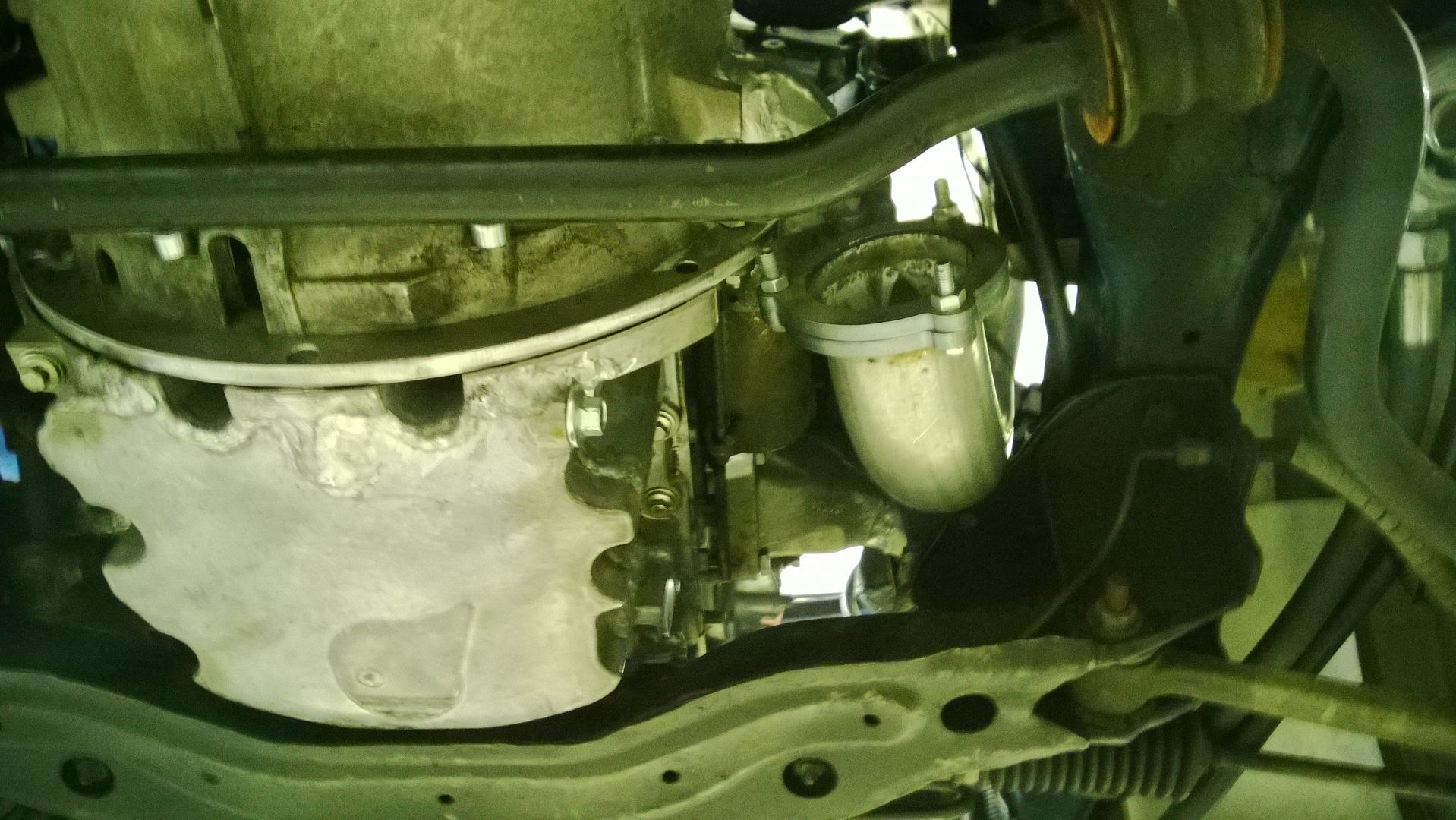

Engine and gearbox adapter is this.
The center of the checkpoint that.
capri71
Er, the bit in the middle was to check alignment? and you'l cut it away? or am i being a thick as the plate you made it from? ;D

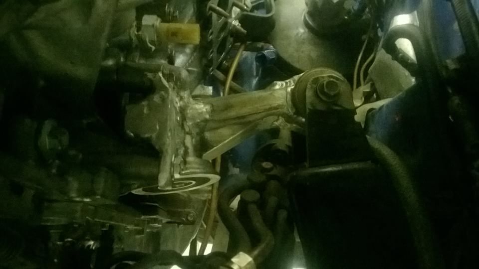

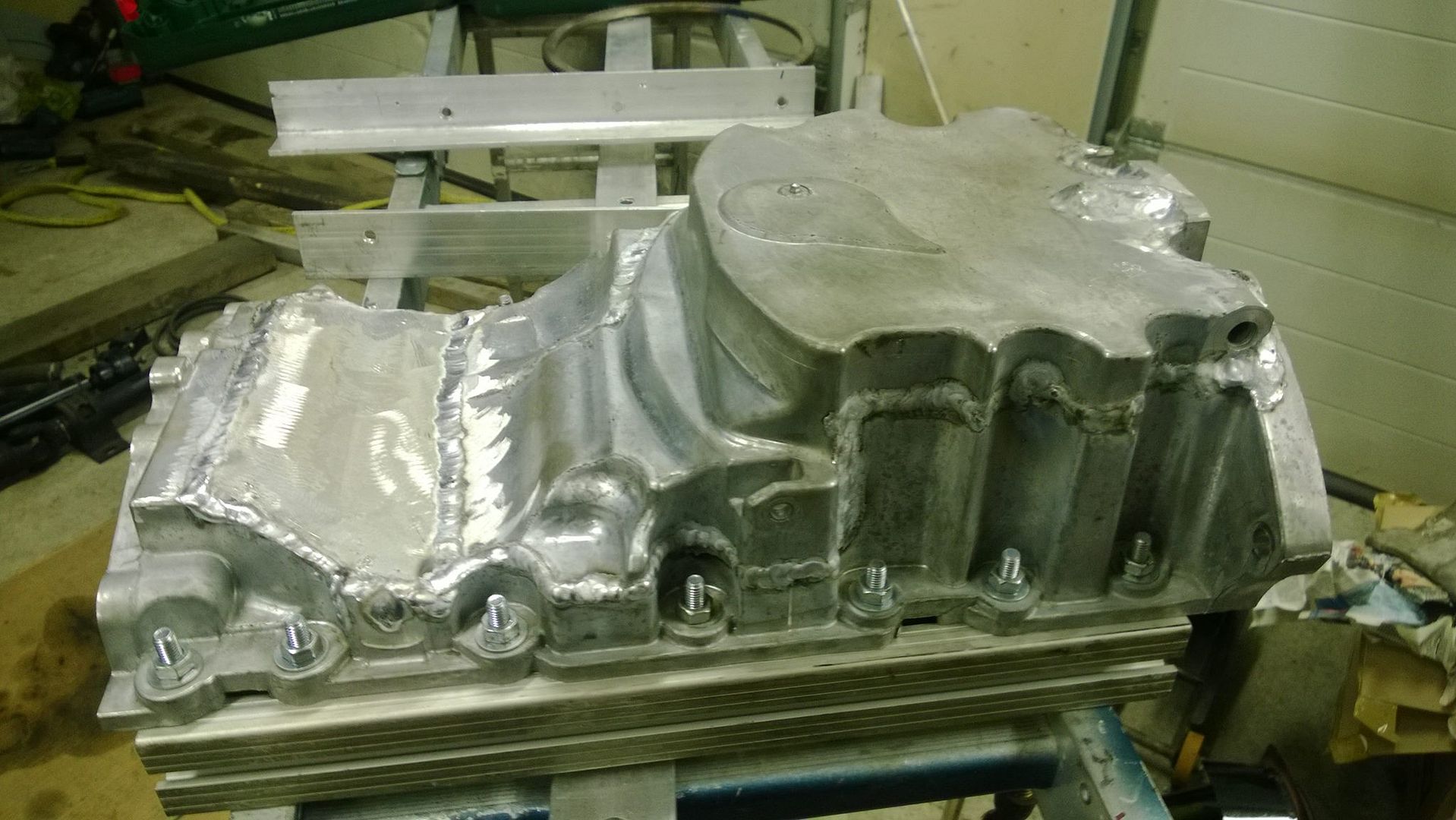

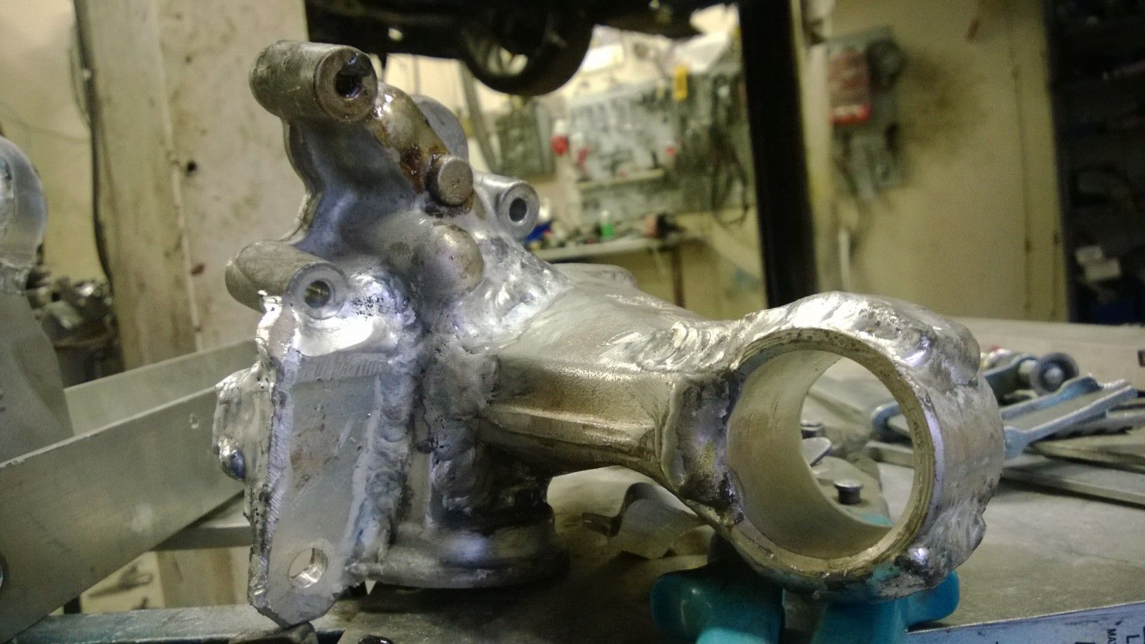

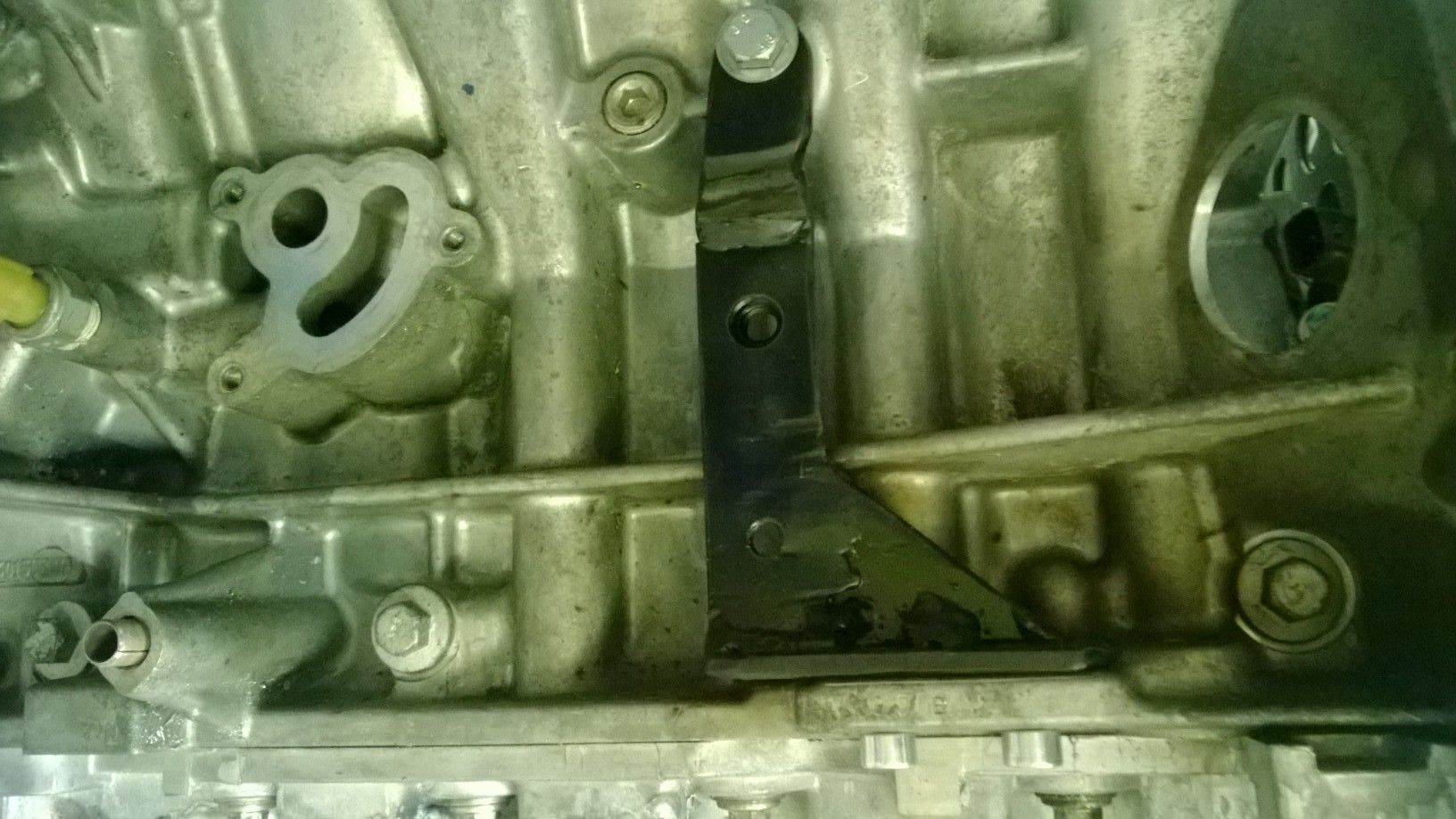

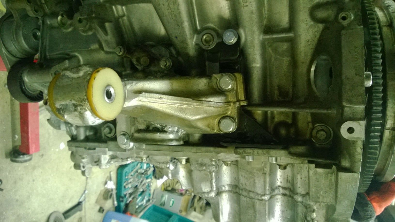

I  welding to TIG the passenger side mounting. Is it any good?  ;)
and the mounting location on the engine.

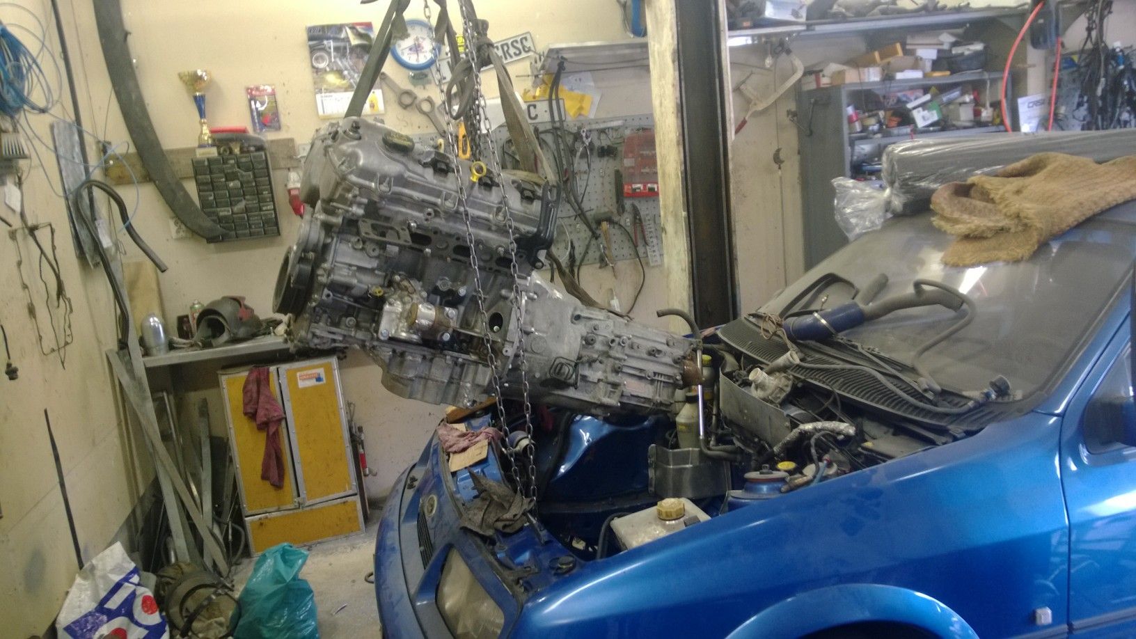

Lowering engine about 30mm. it is better now in the intake manifold and the gearbox angle
Next, lift the package in the engine room, and build mounts
capri71
Pete, I think you are rushing to get this done for the summer. This Sierra/cyclone build isn't simple. I think you should slow down, let it be done when it is done and make it so that you don't have to ask us "is it ok?"
i think the sump looks ok... its just the mount that bothers me a bit!
I am really interested in following this and know you can do it properly if you weren't setting deadlines to get it done - keep on keeping on bro ;)
puuhapete
Quote from: capri71 on May 31, 2014, 15:53:01
No, I did not come to ask you that whether it is ok. I'll do it this way and everyone can actually do better. ugh. :mellow:

At all events, but I installed the engine in place. A tight fit was.
Next time,next feeling.

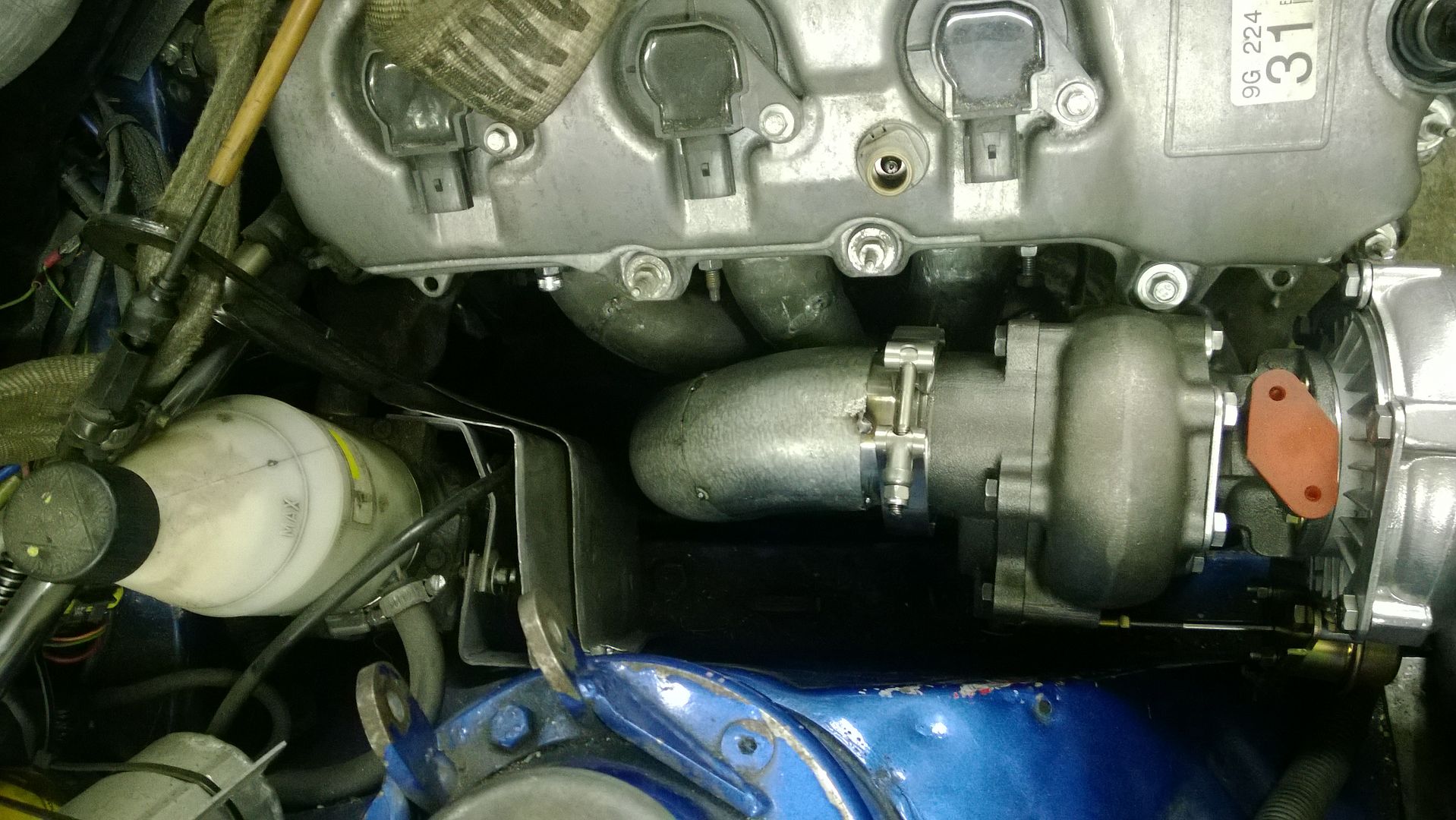

I looked a little turbos places. I think that they will remain in it.

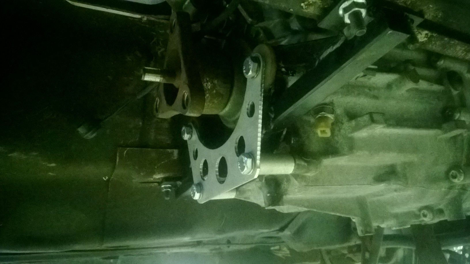

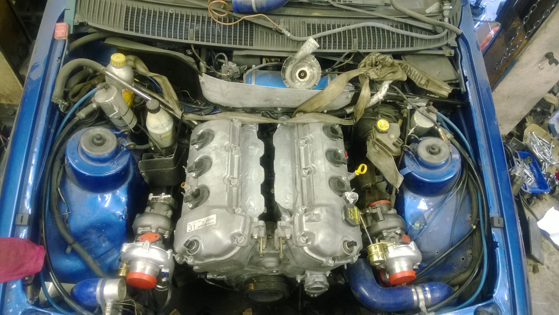

Engine and gearbox mounting now.

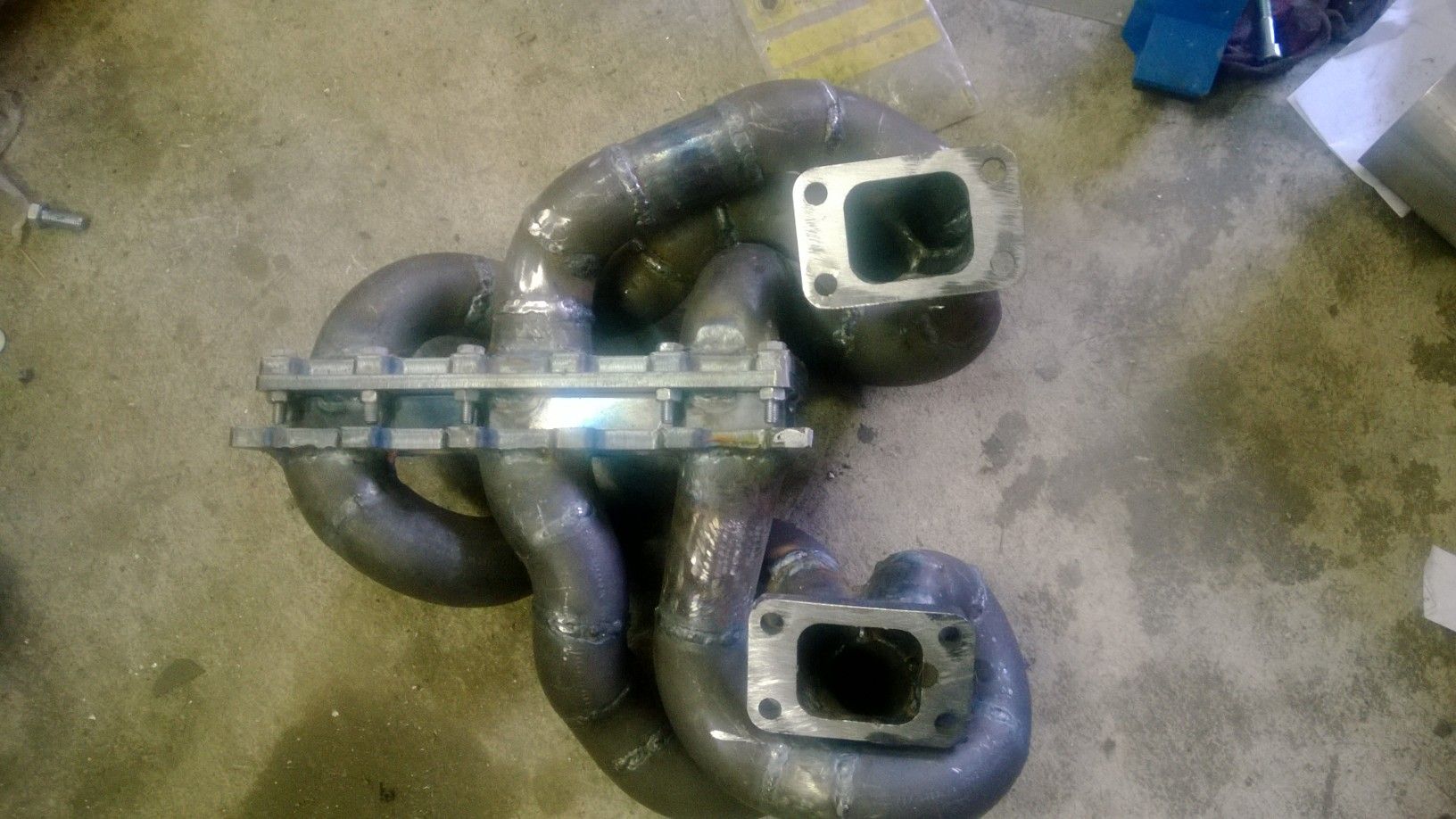

Exhaust welding and ready to start painting now.
Downpipe right hand side:

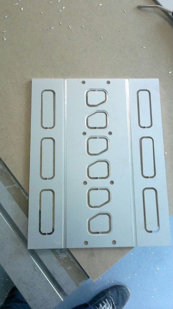

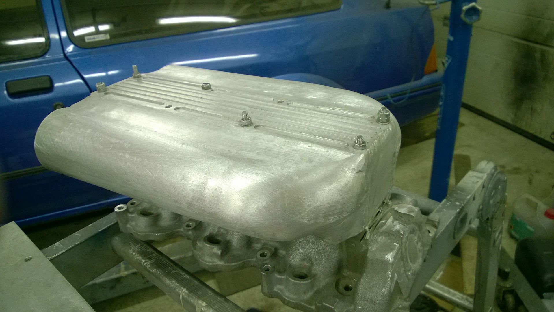

Milled intake blank

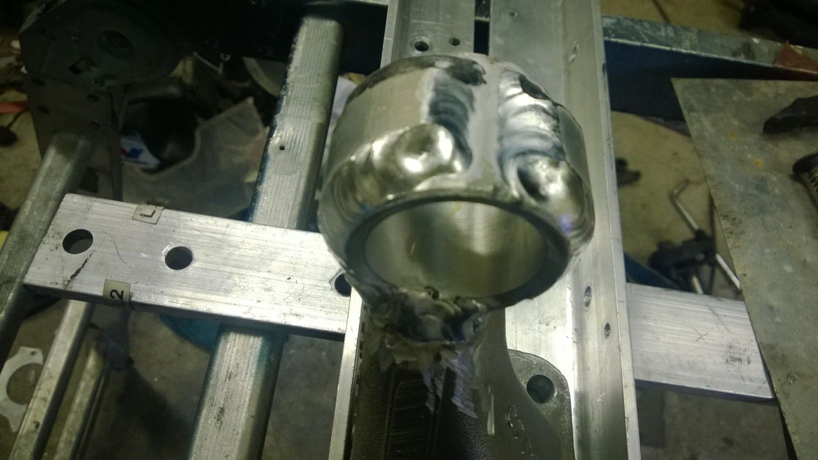

puuhapete
Tig welding training session in progress. See it now, then show today.
Cheers
Pete

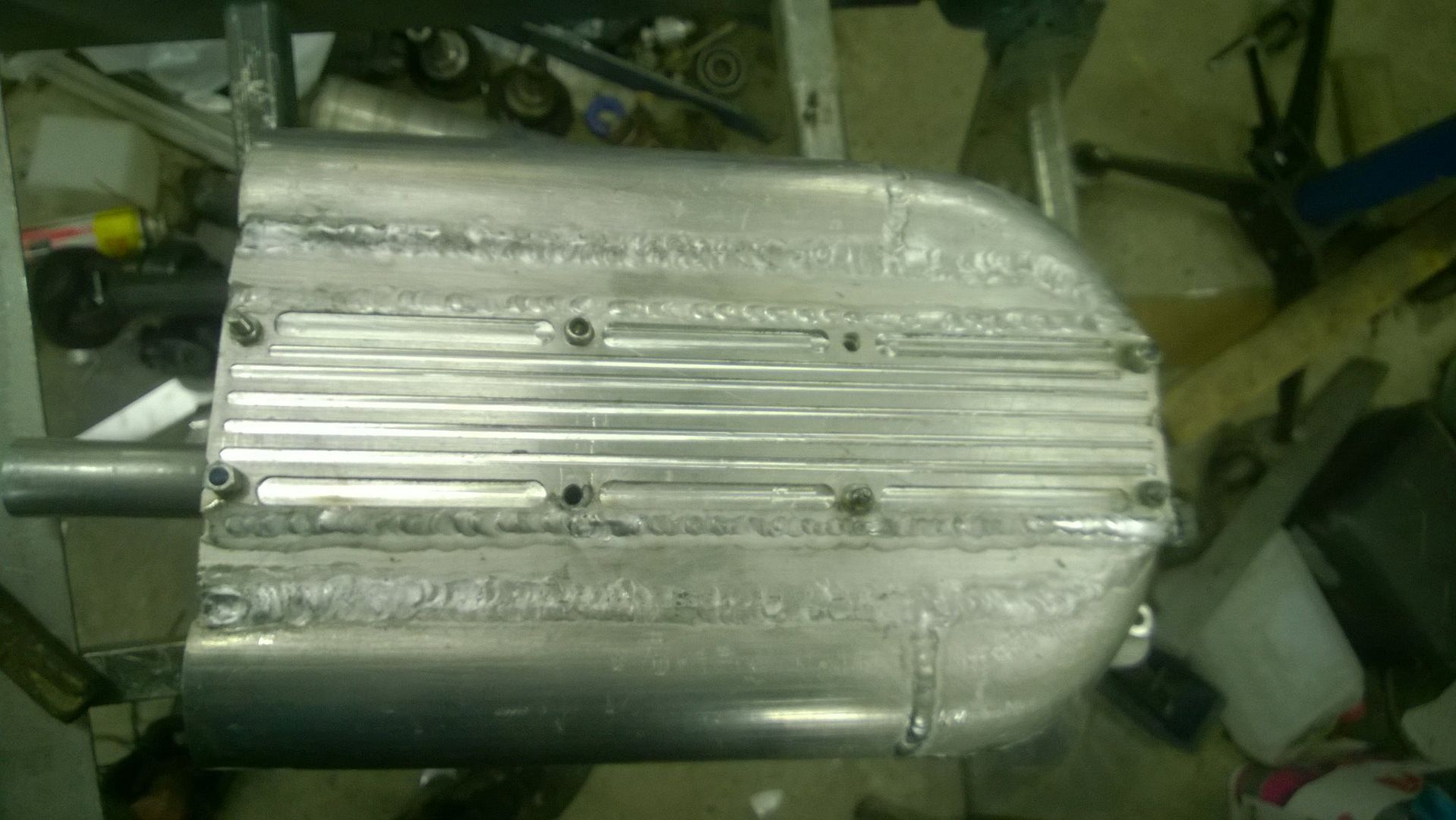

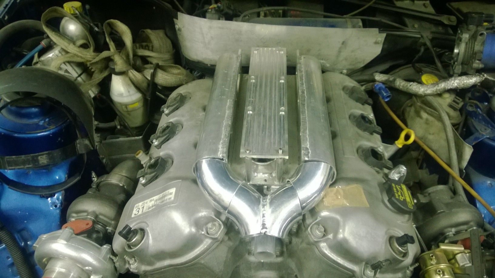

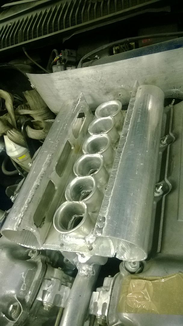

I making intake again. step by step, slowly but uncertainly.

Welding school again.
End is ready

And engine and gearbox look today this.
Heath Robinson
That's a good looking lump! Good luck getting it into the car.

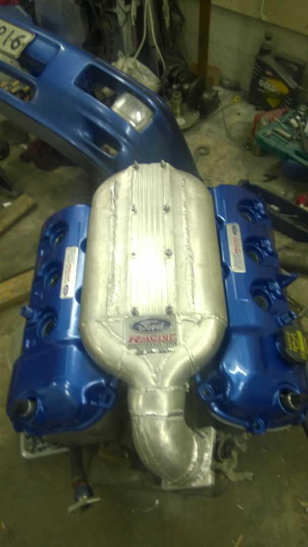

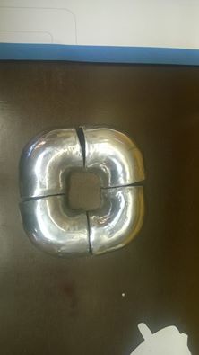

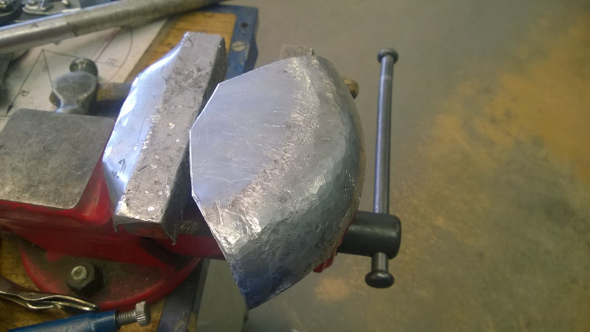

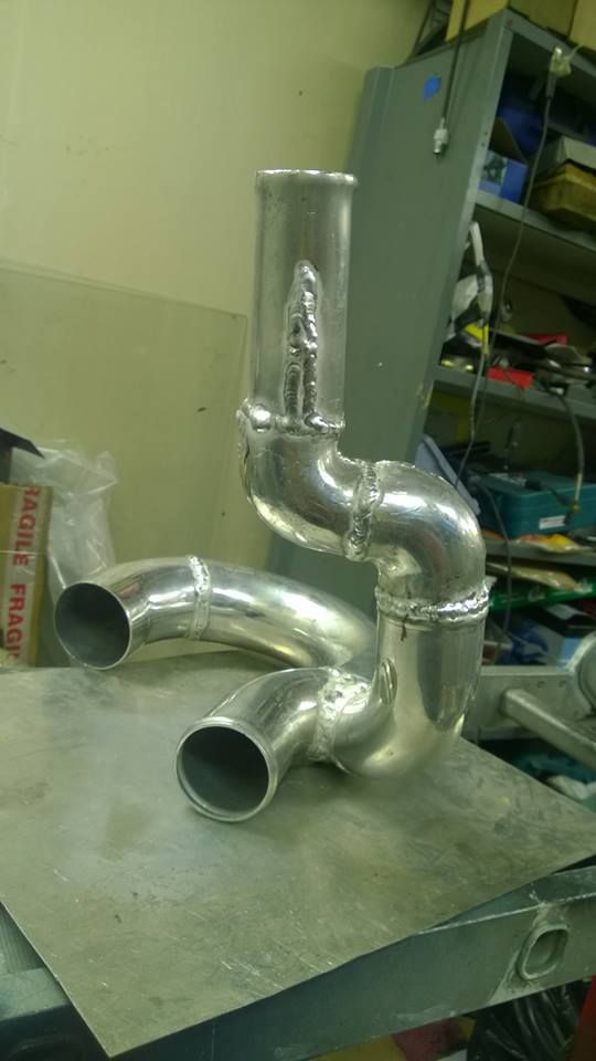

Diy aluminium curve small degrees.
last day pipes

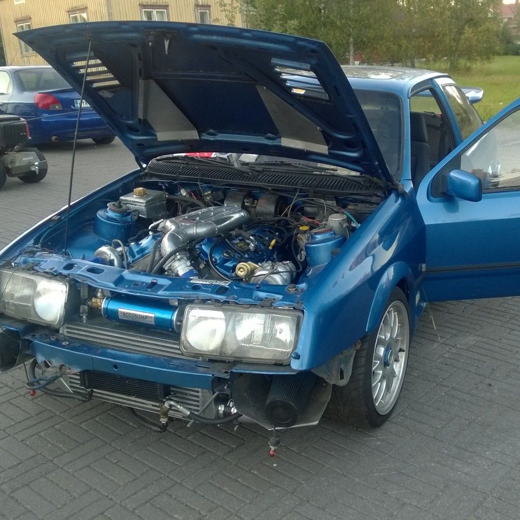

Long time this project but this it is now.  :laugh:
Lemon-Ade
Well done Pete, that's looking very nice and sounds great to :2tu: you must be over the moon with it.

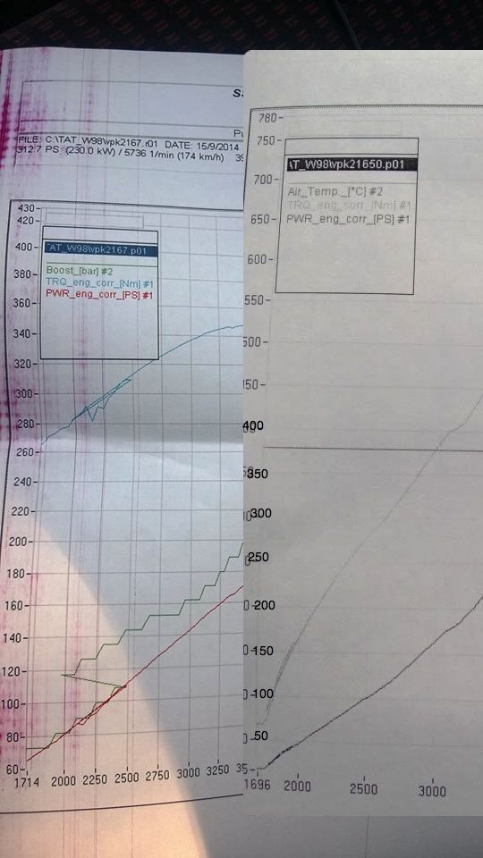

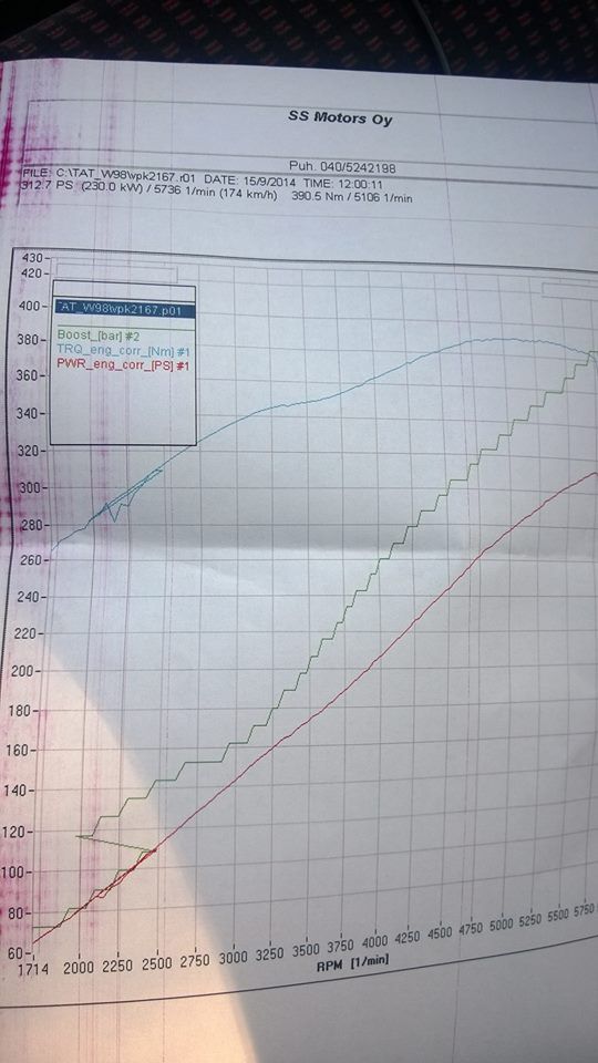

How knows, where we are next summer. But this curve today. Only boost 0,37 bar (turbo housing, plenum little low this)  Stock injectors, but fuelpressure is 4.0bar and FSE regulator 1.7X
No monster, but torque start fine.
Next bigger injectors, maybe RE85 fuel and boost.
capri v8 driver
The engine response very good to even low boost.
puuhapete
Quote from: capri v8 driver on September 15, 2014, 19:02:05
Yes, old 4.3 engine 2000rpm about 175nm and this is 285nm.  :mellow:

Now turbos is again china garret. Godspeed marked now ;D
Turbine ar .63
55.79/63.36mm
Comp. ar .60
54.28/71.32mm
puuhapete

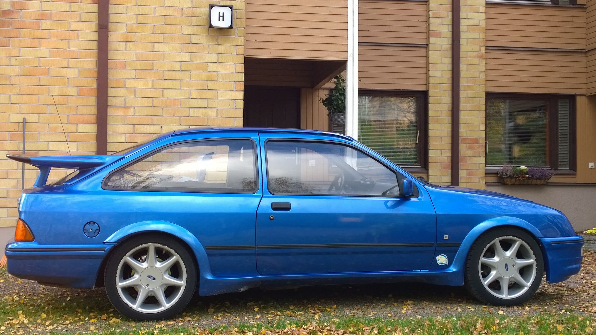

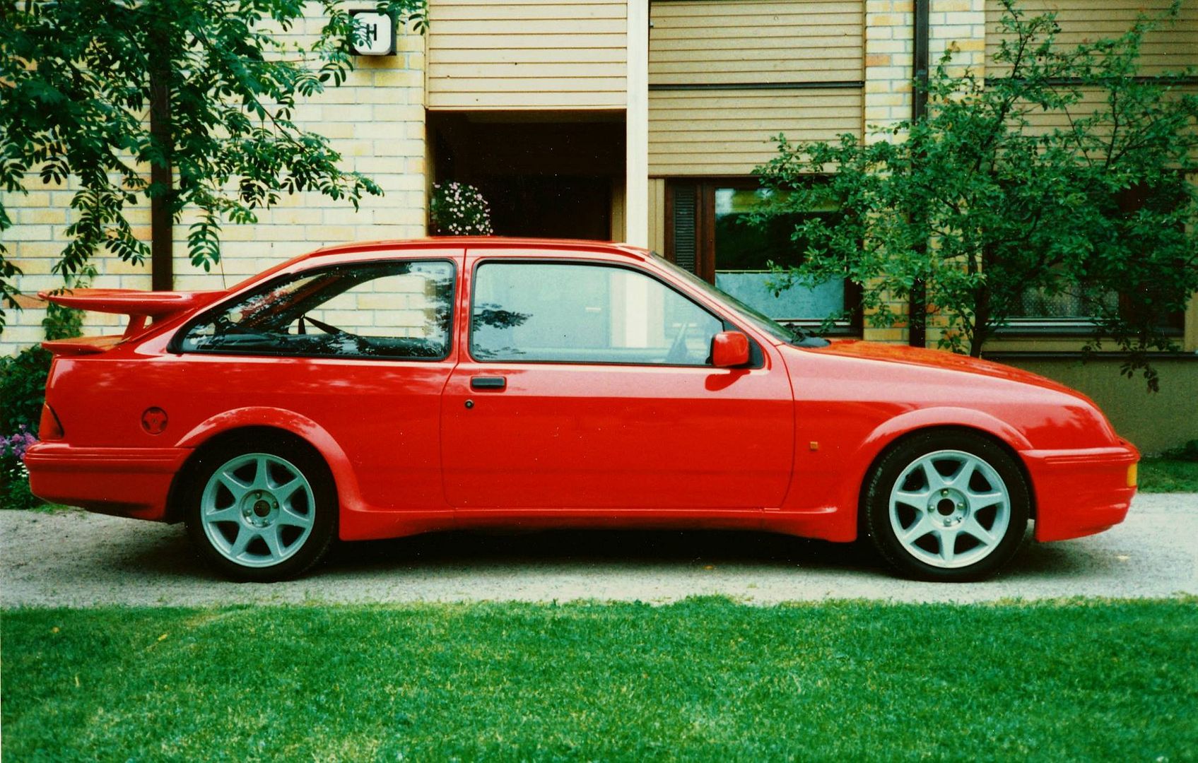

The classic images today. Year 1991 and the previous owner of this car image. He has also shot a lot of pictures of the rally in the world and his name is Kari Nääntäinen. Wheels is 16" RS 7-spoke and Good Year 195x50 tyres.
And I take same place phtoo yesterday. 2014.
and park hall whit good lights to pics.
Pete
Them pictures only make it look like the cars had a respray & some different wheels.
However we all know different! :o  :2tu:
It's been a well loved car!
Turbo's are big T3's then, wish you would go for something more modern mate but they should work O.K.
