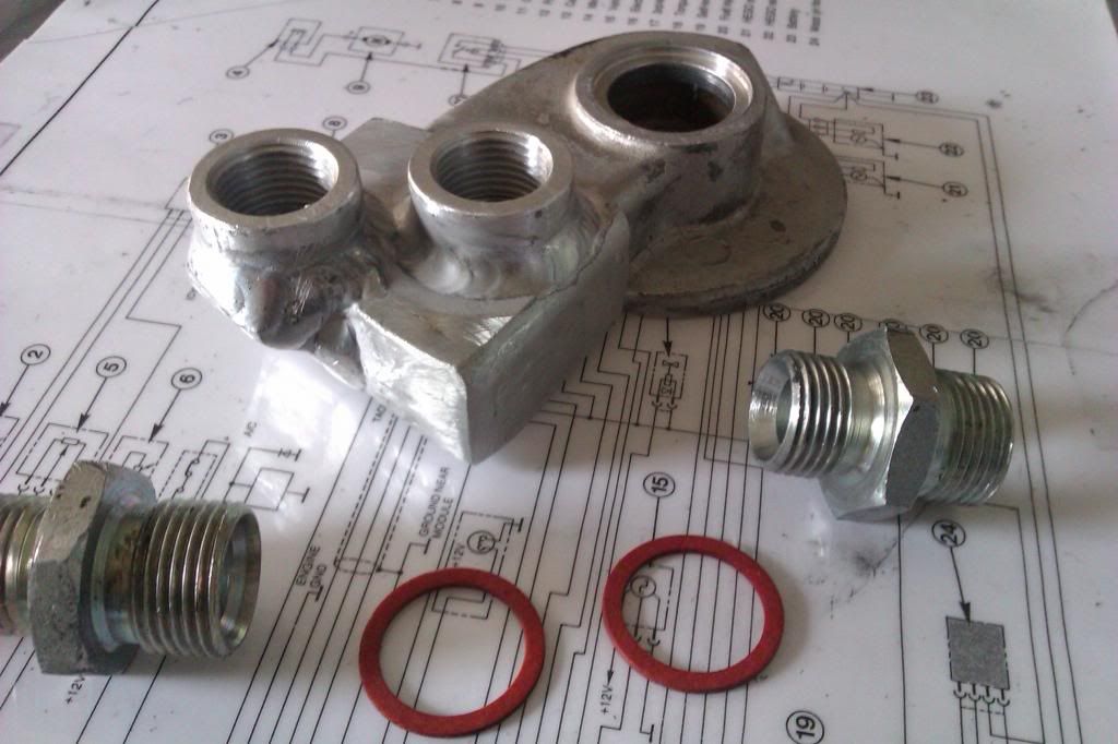

hi all , back to the drawing board i think , was changing my electric fan to a double cosworth one , ran up for temp check and to change oil , noticed large oil slick under neath ,this has let me down think im gonna have to get ally blocks machined and threaded then welded on as threads on original just pulled though (too shallow) i think
capri v8 driver
That's not original adaptor but something homemade. By the looks of it the surface isn't flat or straight to make a decent seal.  It looks like the threats of the connector did not went deep enough and it was only holding by 2 or 3 threats. To make it seal you have to tighten it pretty hard. It is only a matter of time before the threats gets stripped. Be glad it happened in your garage and you spotted it on time. Not while driving.

the mocal unit is the one i already bought , top one looks nice but what about the front cover , anyway its been reworked ....
JFB Tech
That looks better, more thread to engage.  I would feel inclined to use Dowty seals rather than the fibre ones, they'll probably seal better.
