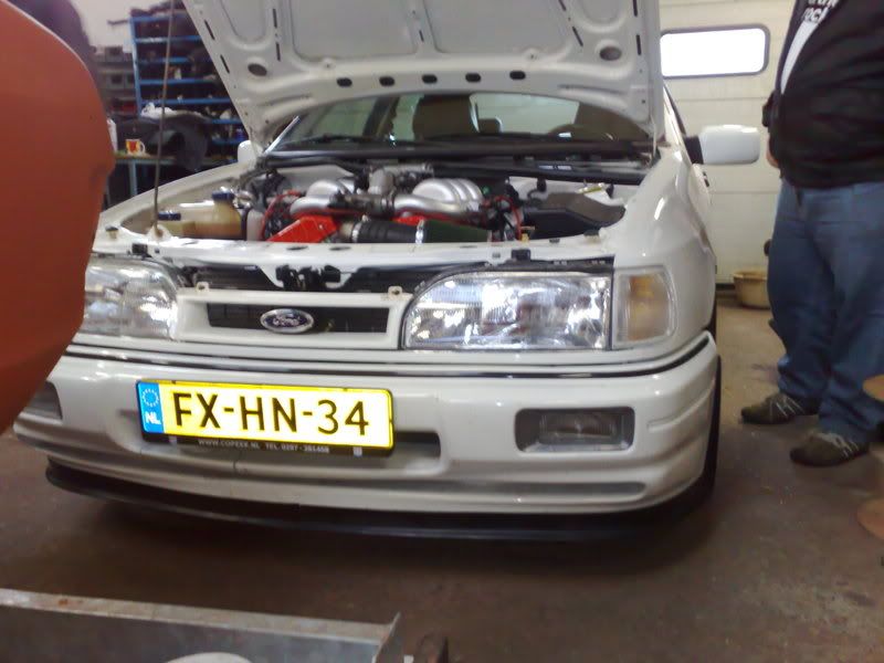

Today it passed the RDW technical test with flying colours.      The experts at the RDW checking the car were impressed with the build.    They asked why the rearaxle isn't Polybushed. Because we didn't get around to it yet.
It weighs in at 1290kg so it only gained 120kg over a standard 5dr twinky. And we had it weighed with a full tank, 17x8" OZ rims (those weigh quite a bit as well) the testers said that's quite light for such a car in full road trim (leather seats, the works)
CO was 0.25%, again our theory that the engine is a very low-mileage one seems to be acknowledged.

Damo sold me his RS500 splitter so when they were over a couple of weeks ago we fitted it:

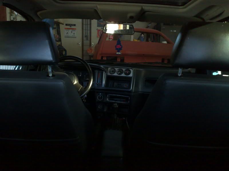

And a couple of random interior shots, I don't mean to brag but I haven't seen many Sierra's with a better looking interior:
The retrimmed headliner:
Interior shot:
And how we've secured the sapphy rearseat:
Part of it has been grinded out of a sapphy to make things a bit less complicated. It's a lot more sturdy then the standard hatchback rearseat securing, which frankly, is pants. The rear seat in a hatch always sort of callapses where it is devided. I didn't want that so we started welding. Original rear self won't fit anymore but I don't really care because that is pants as well. always sagging like hell and no good to put speakers in because it's far too weak. I haven't bothered making one because that will only add dead-weight. I haven't  a stereo in it anyway.
