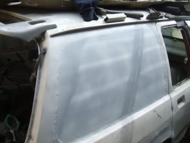

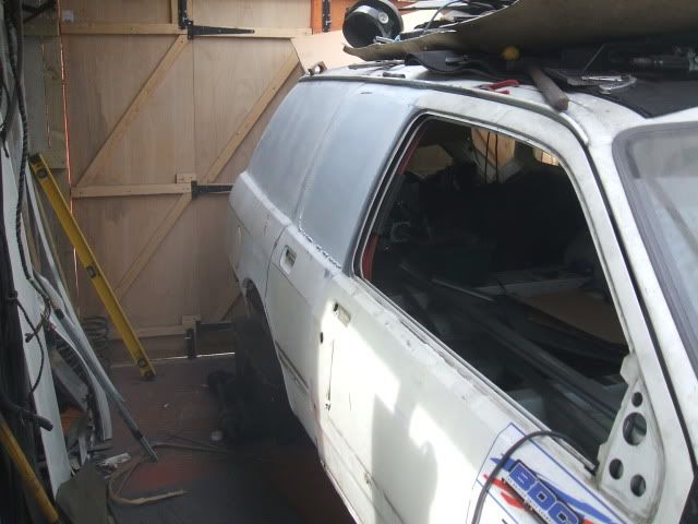

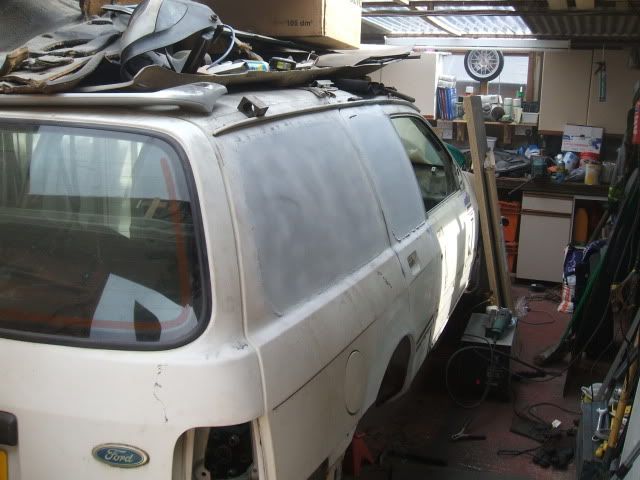

Update.
Got the side 90% finished. Only got the sills to rebuild, seat mount to do, rear chassis rail.....
Then i have to do it all over on the otherside
Pics so far as the day went on today.
It's not quite finished as you'll see in the pics, but it's gettin there.

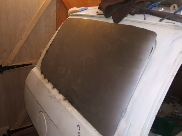

Started off like this this morning.
Finished tacking the panel in......
and put the second one in...
Ground all the welds back and put a quick coat of white primer just to seal it up.
Just the door shuts to weld up and also the old door handle on whats left of the rear door.
Hope you like so far guys and gals....

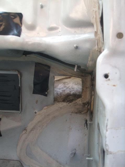

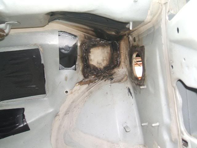

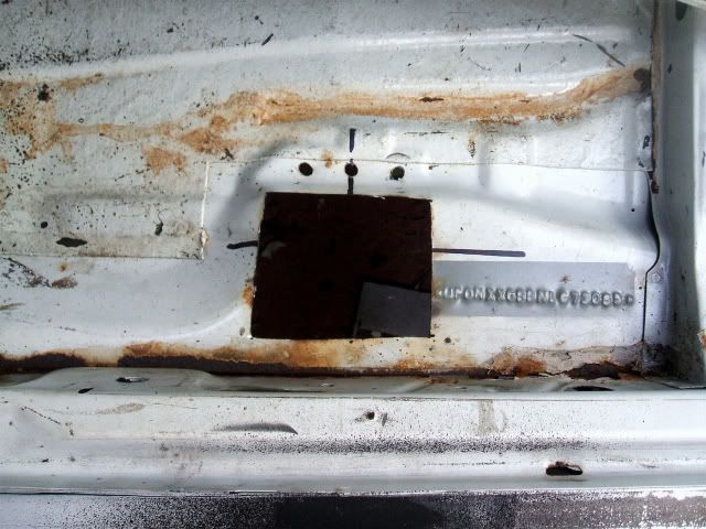

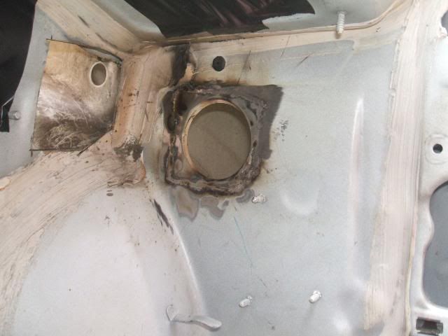

I finished welding the rear door in and decided i wanted to turn my attention to the bulkhead. My idea is to run the wiring loom inside the inner wings like they do on the later escorts.
So here it is so far.
Wiring grommit hole cut out.
welded into it's new home.
Old hole filled in, and how it looks so far.

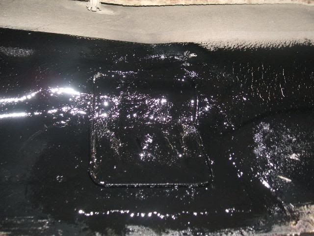

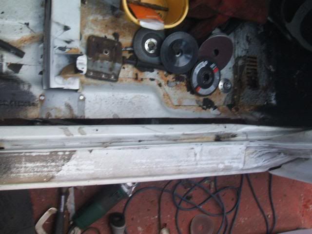

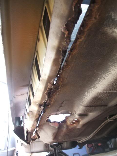

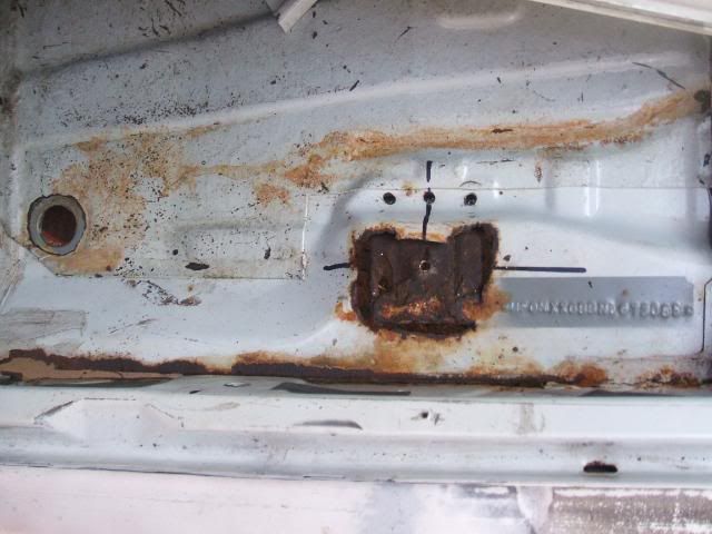

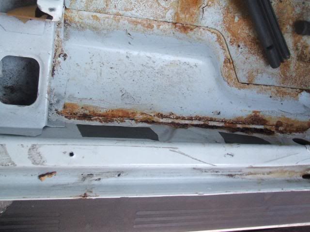

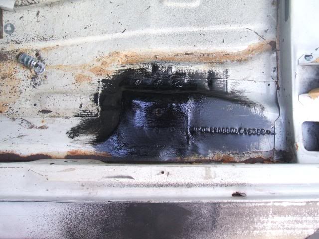

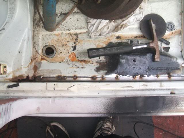

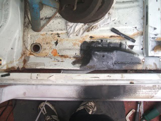

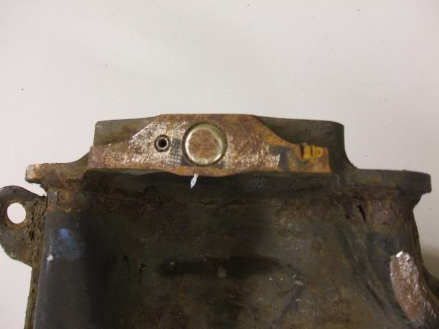

i decided too tackle the rust issue in the floor, sills (inner and outer) and seat mount.
Heres the pics of progress so far, just gotta get my mate to bend a couple of sheets for the floor for me.

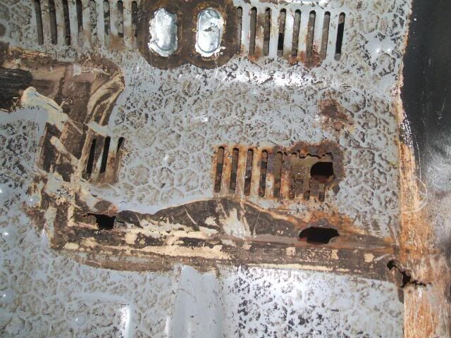

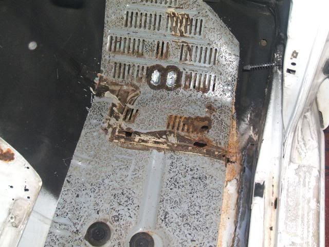

Heres how the floor started out.
As you can see, rust and lots of it...
Cut out the seat mount and removed the absolutly rotten support bracket from underneath too.

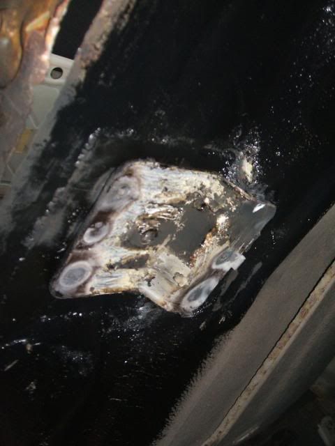

I then put in a fresh piece of steel once i'd cut out the rusty bits.

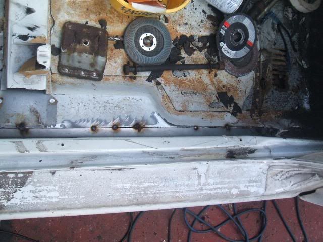

Spot welded a mint seat mount back on.

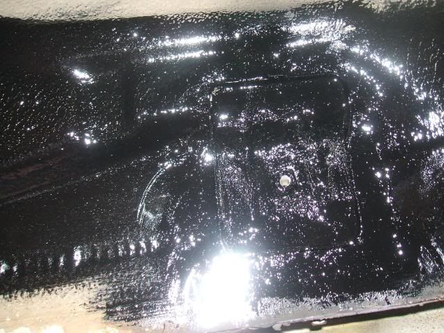

Gave it all a lick of chassis oil resistant black and started on the inner sill.

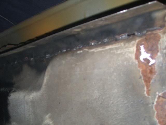

Just a quick pic of the repairs to the inner sills as i just plodded on to try and get as much done as i could.
Just floor repairs, middle sill and outer sills to do then one side is finally complete.
Just gotta do it all again to the otherside.  :bigcry:

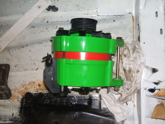

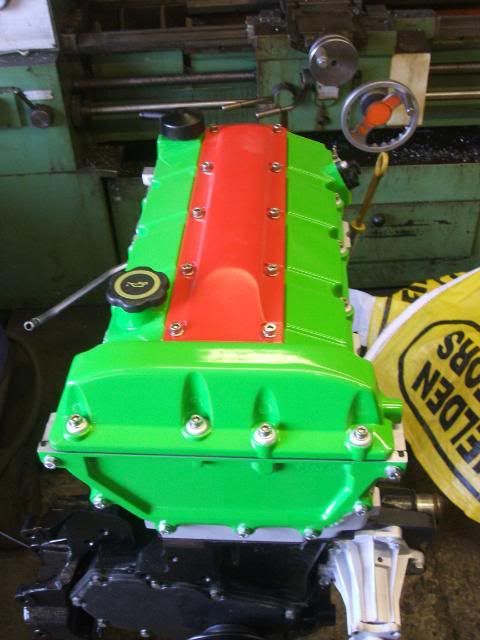

So, ,i started with a relatively easy piece to strip, overhaul and recondition.....

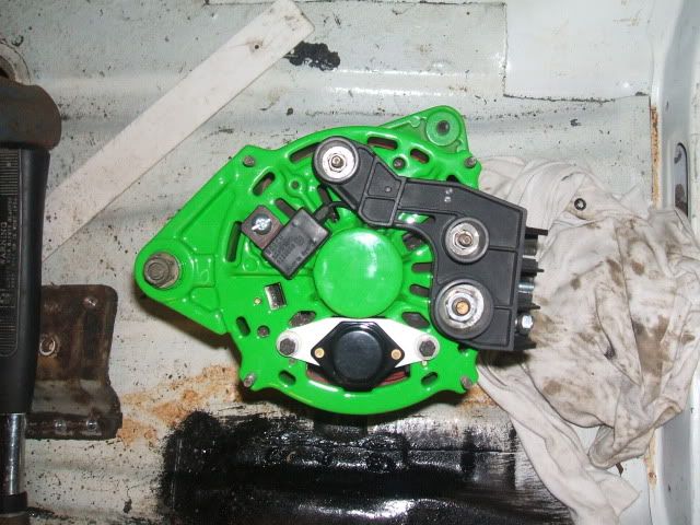

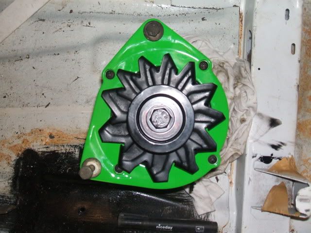

The alternator:-
I didn't get any before pics but you all know what a dirty alternator looks like, the colour is a clue as to the final colour of the van too....
Fully stripped, bead blasted and then painted in............................................
Wait for it
Kawasaki green, sorry for those who don't like it.....

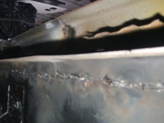

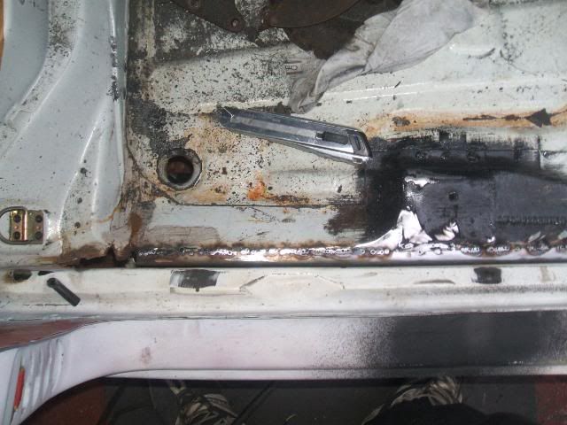

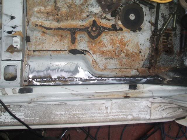

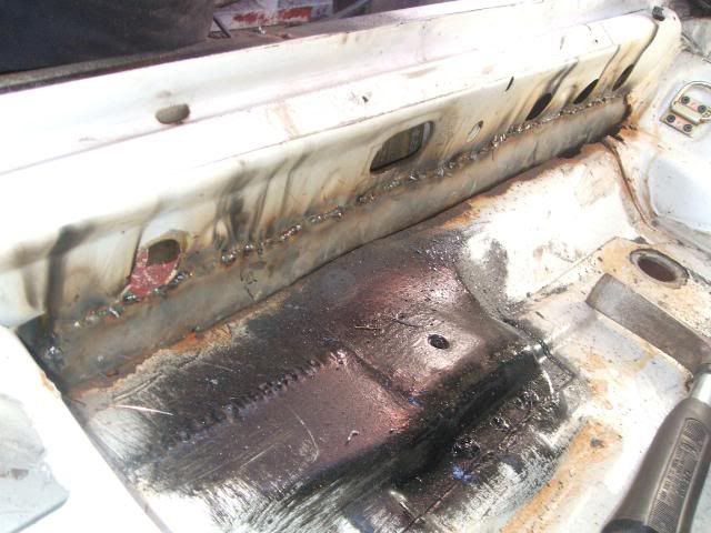

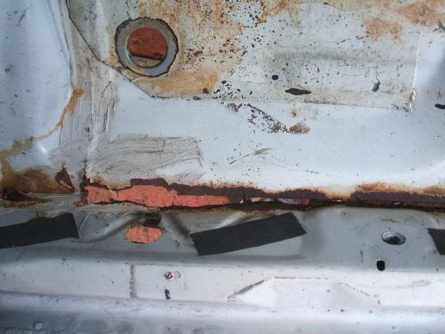

I started cutting the rust out of the floor and was left with this.
Tacked in the replacement steel and lined it all up.
All done.
Underside view, bit of a clean needed under here. Once the under sealant is on you'll never know any differant.

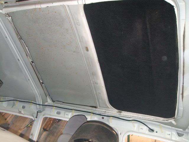

In between welding the floor together i started to remove the sunroof housing as i'm desunroofing it, giving the floor cahnce to cool and not warp.
All gone, nearly, i'm leaving some of it attatched to the roof to stop it sagging down.
I also spotted a couple of 'blisters' under the factory sound deadening so i removed the lot to investigate further and found just a couple of holes that will be cut out and plated up.

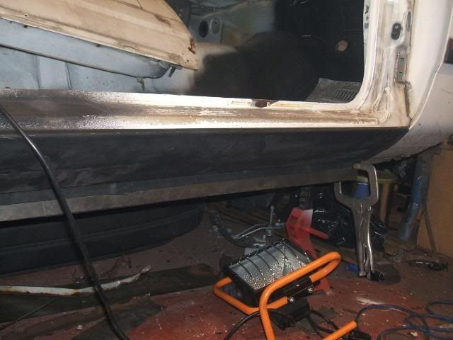

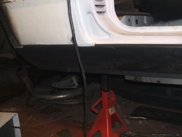

With the floor all welded up it was time to mock up the outer sill cover.
And thats where i'm up to so far.

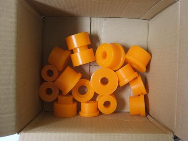

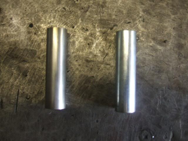

Bought a full set of flo-flex poly bushes (2wd cosworth)
Gonna take all the steel sleeves into work and copy them with stainless.

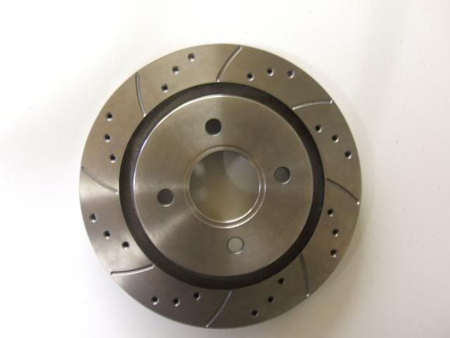

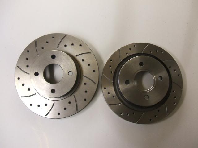

Also bought a set of 2wd cossie front discss and a set of 4x4 cosworth rear discs off mtec on ebay, not bad for £150 for the lot delivered from ireland.

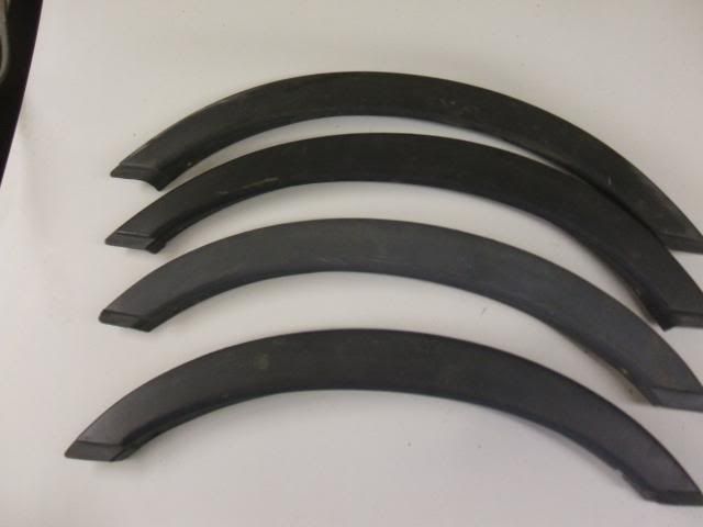

A set of 4i arches

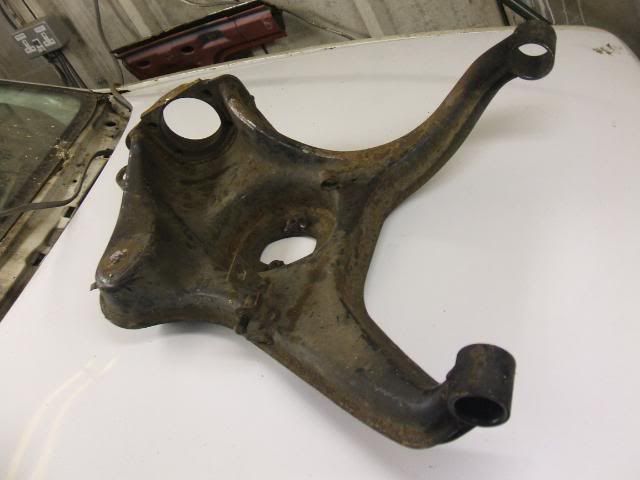

and finally, some granada estate rear arms with arb mounts
Put a couple of extra welds on the shock absorber nut that ford only lightly fuse on in the factory, also blanked off the abs holes as i wont be running abs.

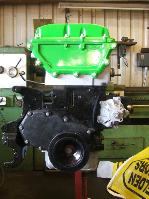

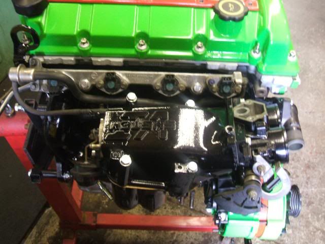

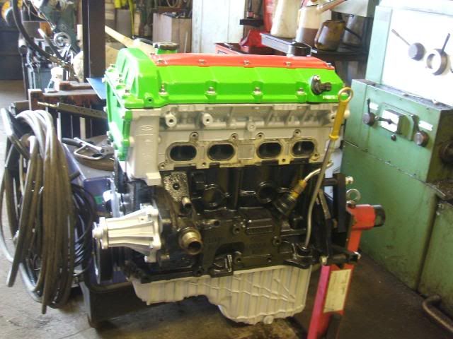

Finally got the last bits together to build my engine.
As always, i'll let the pics do the talkin.

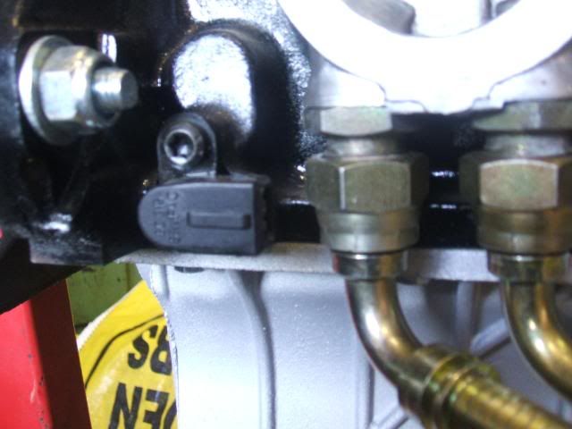

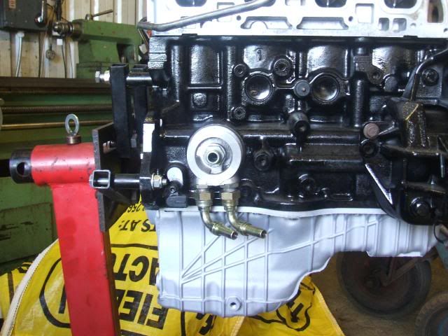

Sump with oil temp sender mounting point in it
Mocal oil cooler take off mounted

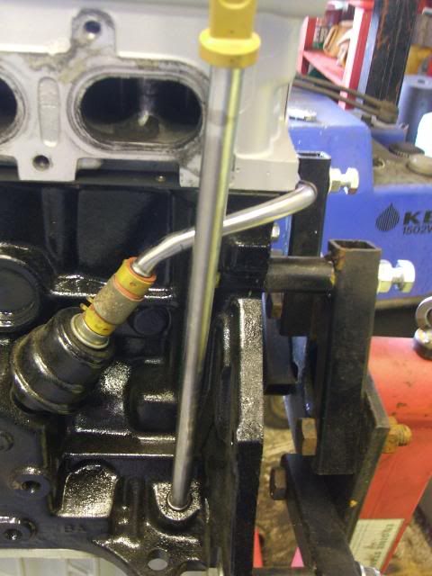

Very close to the crank sensor....
Polished dipstick tube and breather
All new bolts externally, and stainless steel ones in the rocker/coil pack cover.

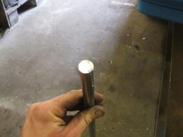

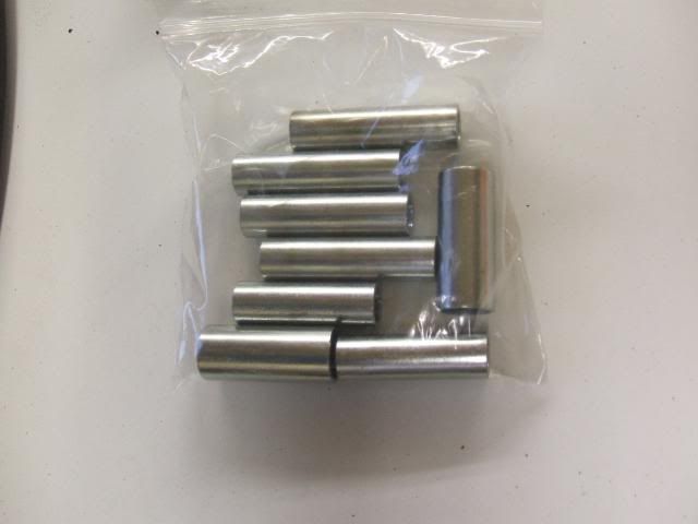

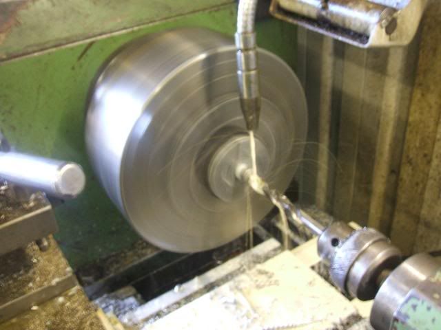

A soilid bar off construction grade stainless steel ready to copy the zinc plated inserts i got with my polybush kit.
on with the machining.
One down..... Stainless on the left and mild steel on the right.
Thats how things stand at the moment, just gotta finish painting the inlet manifold and then i'll mount that. As soon as i make any more head way i'll update my thread.
#16
I hadn't even thought of painting my alternator   something else to do
I like that even though floflex will supplly with stainless OR mild, you took the time and materials (or works   ) to make your own  - did they want silly money to upgrade? they ROBBED me of 8 quid p&p on a pair of steering rack bushes that cost 10

Quote from: JanspeedcapriI hadn't even thought of painting my alternator   something else to do
I did the alternator ages ago just out of interest to see how it'd look, i'm impressed with how it came out and then had to start going all bufty with the engine. The list keeps growing as i've got all the mechanical items stripped and ready for powder coating
I'd heard through the grape vine that stainless inserts were expensive off them so i decided to make my own using works time and materials
In pocket as i'm getting paid by work to make them

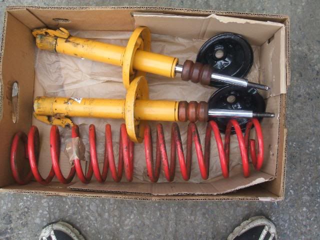

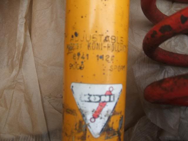

And my latest ebay bargian......
2wd Cossie front adjustable shocks.
Shockers are low mileage and come with some servicable springs and the adjusting key.
