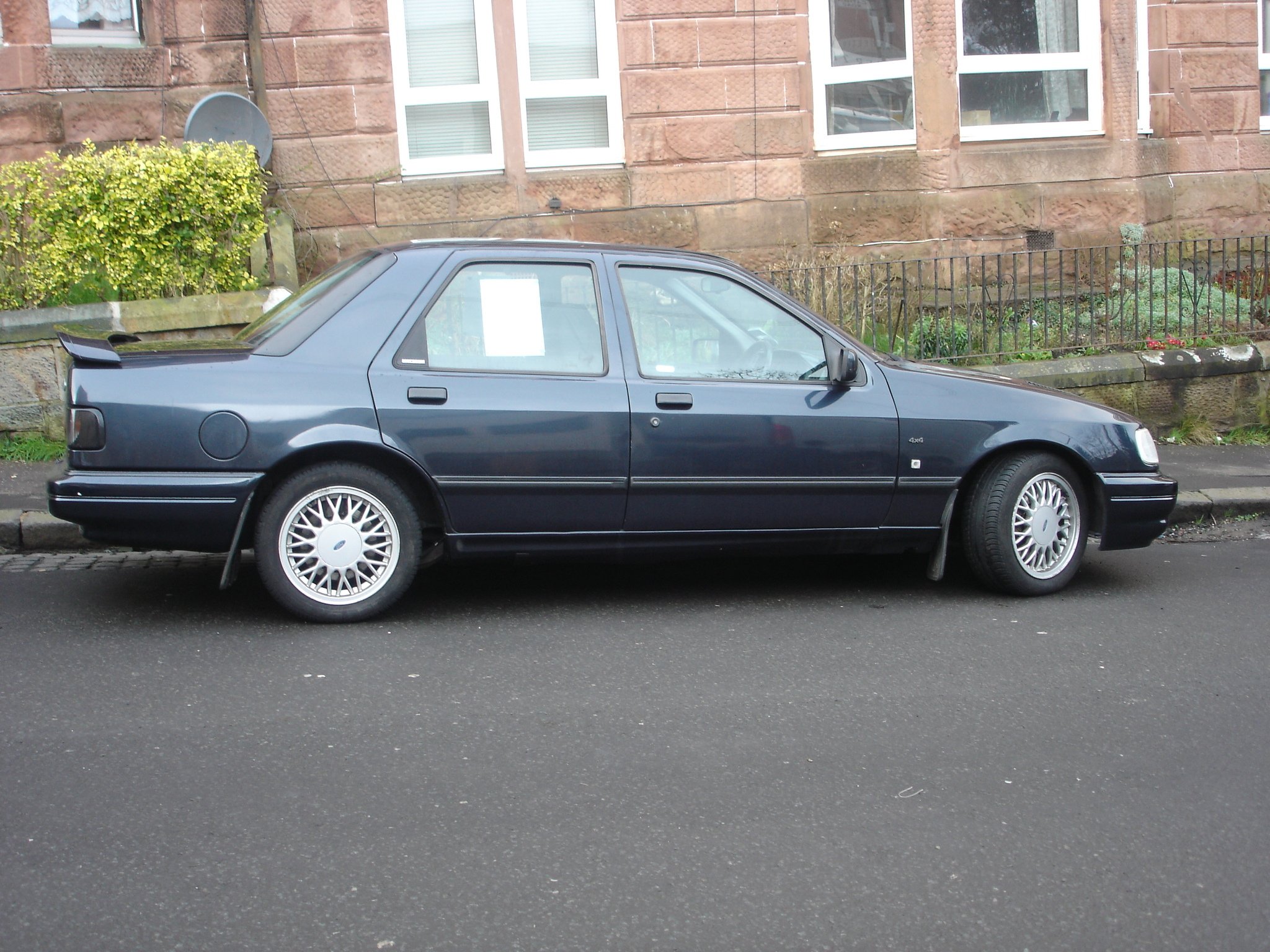

What's the name of the colour the car has? Which colour code?
JFB Tech
Looks like Smokestone to me, the code is M.  There are 3 shades, M1, M2 & M3.  Strangely, the ID plate on the car calls it Smokestone but the official Ford touch up is labelled Mitternacht Blau which translates as Midnight blue.
Of course if it isn't Smokestone then you can disregard the above drivel, just file it away until you get one that is.  I think it should be compulsory to have at least one.
Drive it like you mean it!
Smokestone Sapph.  Best colour ford made next to Imperial Blue
Smokestone is a Blue colour.

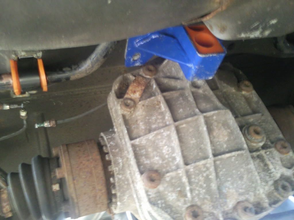

Just a very quick update, I have been in contact with a certain pollybush company and i'm curently having another prototype part made by them so here is a few pictures for you.
#39
Have you already fitted that diff hanger? any rear ARB clearance issues? I've got a polybushes diff hanger as well but needs modding to clear the rear ARB. Most just grind a bit of the top bolt-head but I don't feel comfartable doing that.
Any price indication?
ShaunPC
Quote from: Remko GTHave you already fitted that diff hanger? any rear ARB clearance issues? I've got a polybushes diff hanger as well but needs modding to clear the rear ARB. Most just grind a bit of the top bolt-head but I don't feel comfartable doing that.
Hello mate, yes I fitted the bush to the car no problems at all.
The first incarnation of the bush was a bit of pig to fit but as I have been working alongside the company making these the feedback that I gave they have adjusted things to suit.
As yet I have no idea of pricing but should know what is what by the end of the week.
Out of curiosity have you been using cap head bolts or standard bolts to fit the bush as this may make a difference in clearance.

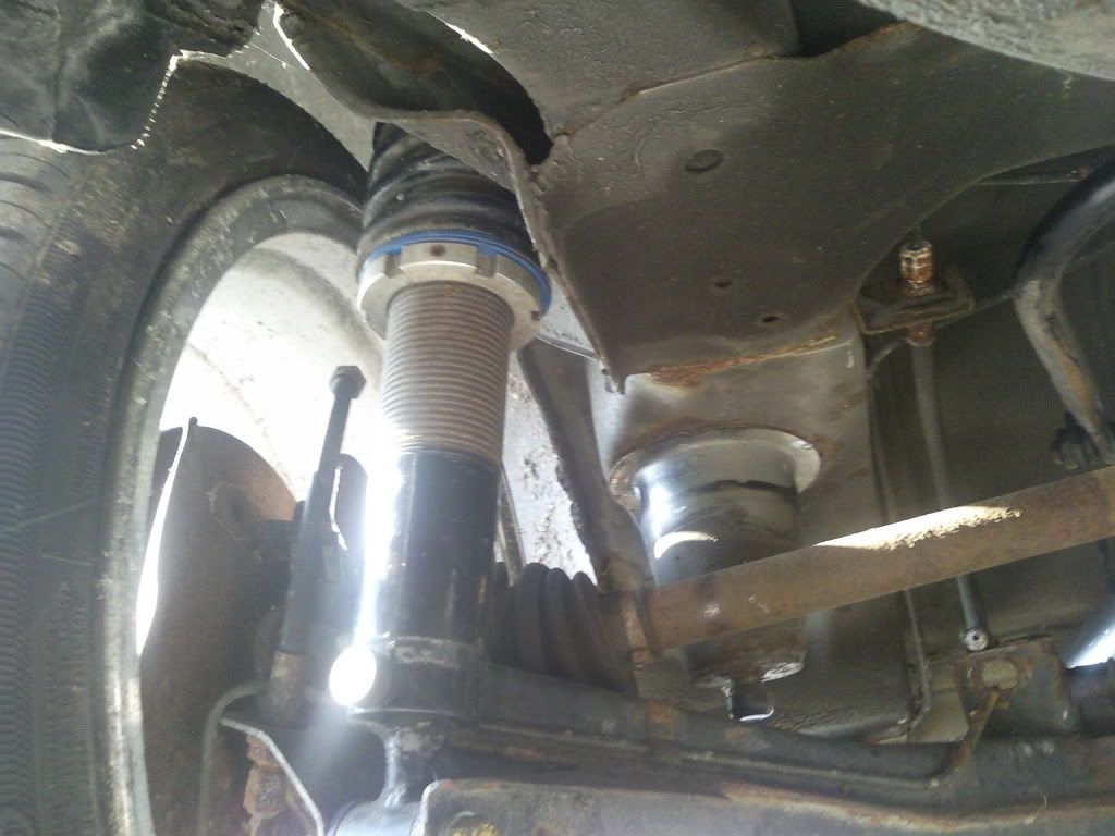

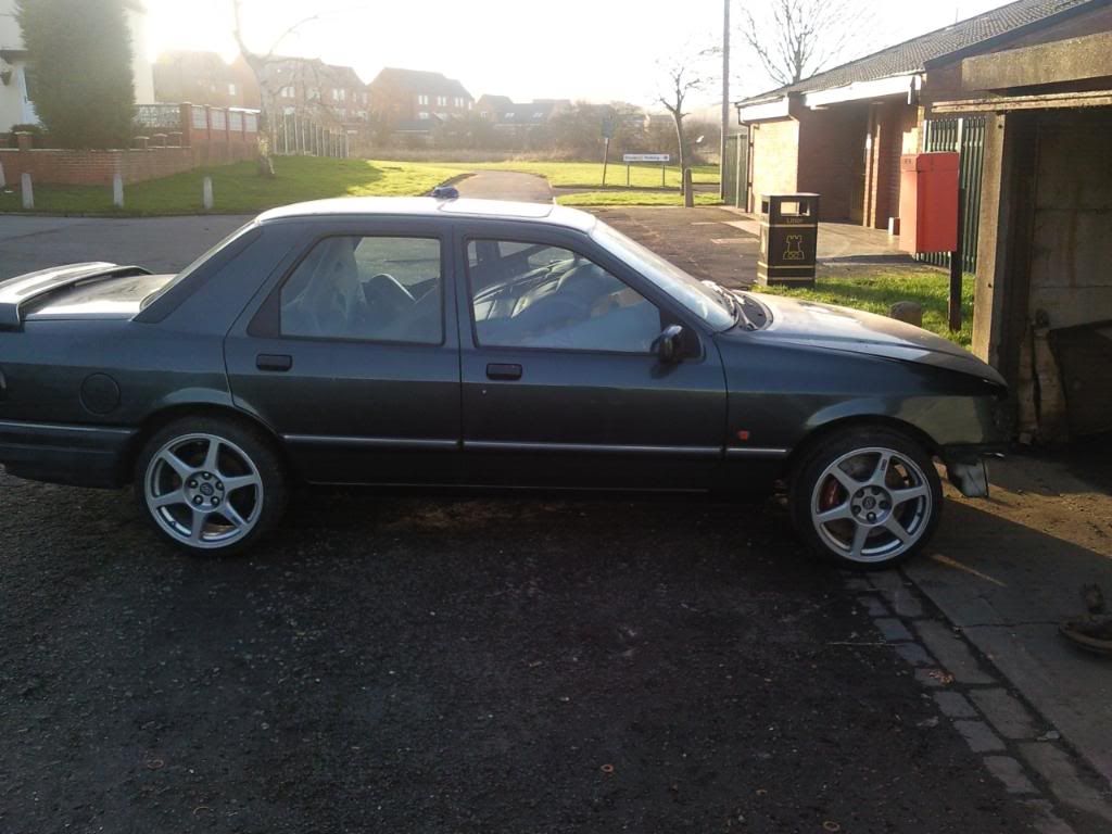

O.k. folks I have pulled the sapphire from the garage and started up the rebuild
Here are a few taster pics of how the car is coming along.
Also another change of plan includes the fitment of AVO fully adjustable coilovers which you can't see in the pics.

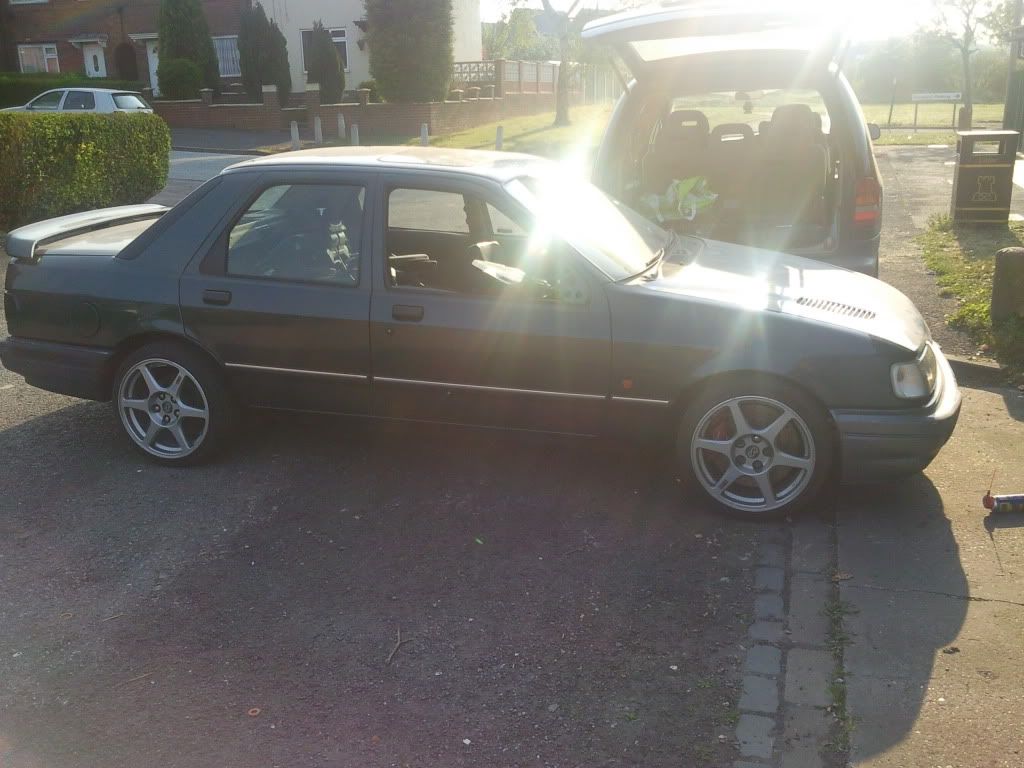

ShaunPC
Just a few updates for you all as to what has been happening with my projects recently.
I know this isn't the best pic but its all I have for this part of the project

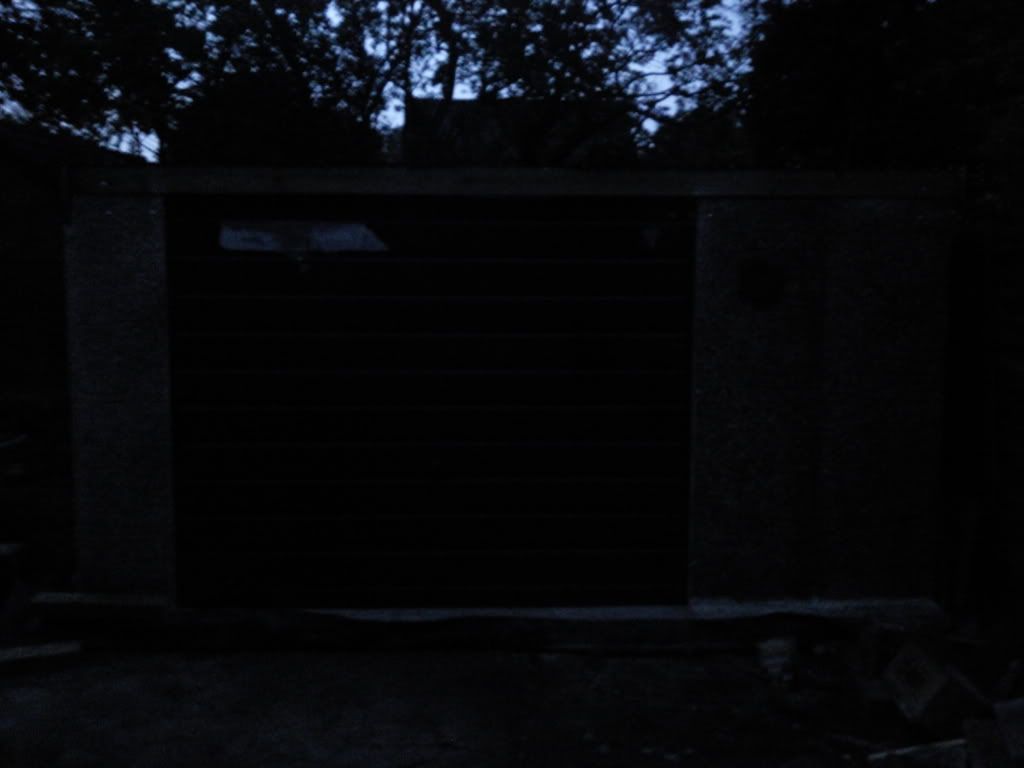

I have finaly got round to building my concrete sectional garage which measures 20' x 13.5' so now I have somewhere to play with my projects at home, I have been having to travel a 22 mile round to do anything on my sapphire but finaly it is home with me. :)
I have had to get it home as it was in the way at where it was stored so I have had a few rushed days with the car.

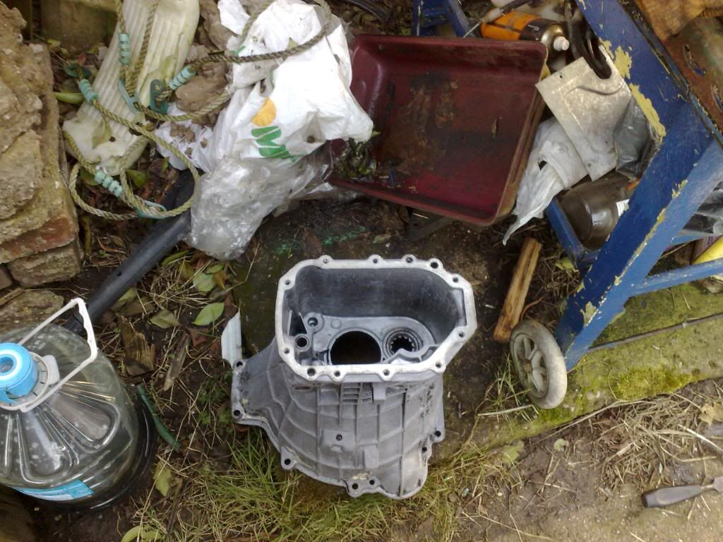

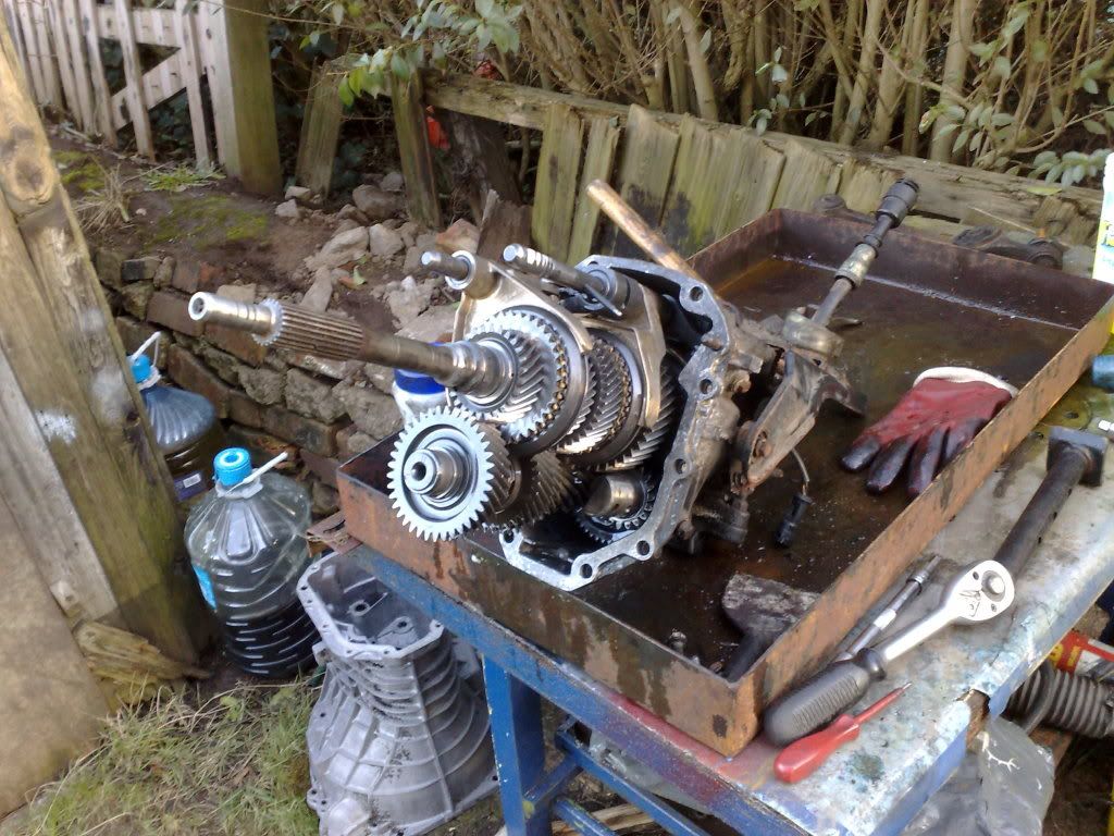

I have got round to fitting my hybrid 2.9 v6/ 2.5td Scorpio MT75 gearbox
onto the back of my 2.9 v6 Cosworth engine from my old sapphire

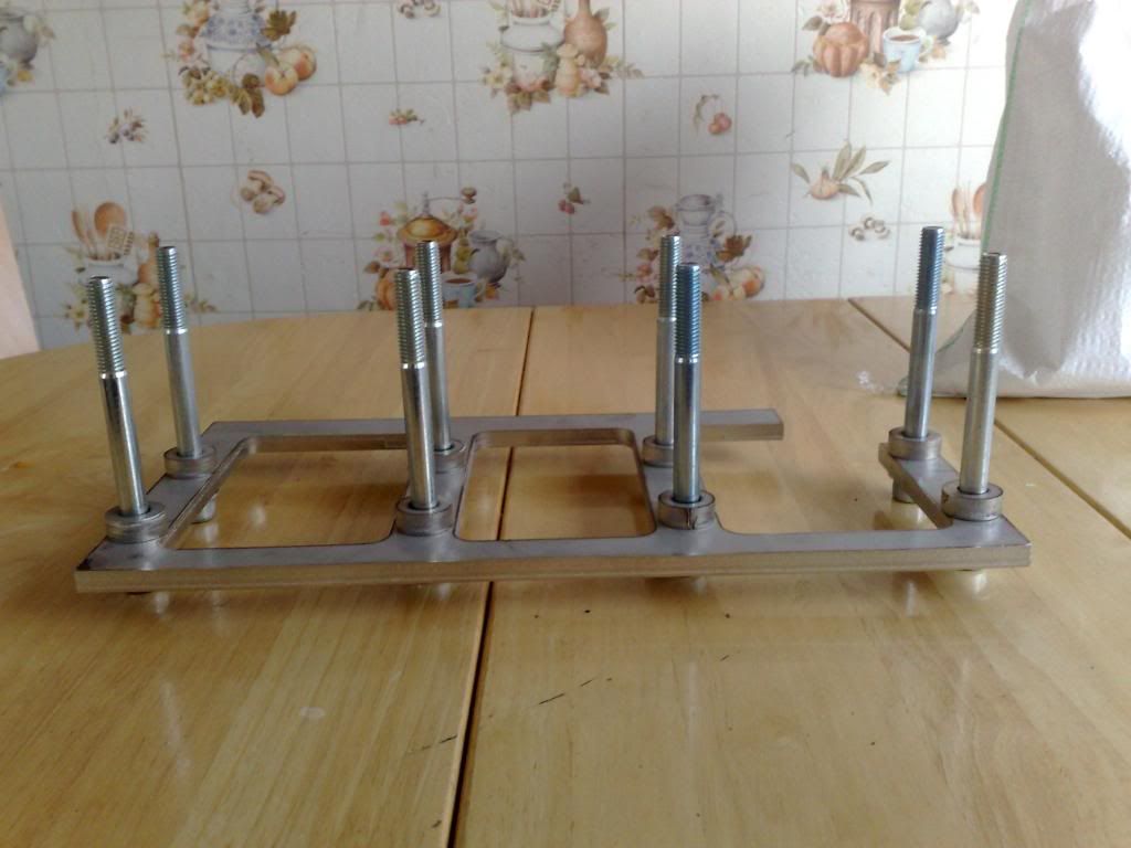

The engine has had all new ACL bearings fitted along with my own main cap brace
which has 12.9 bolts holding it all together.
I have fitted an Alcon 6 paddle clutch with heavy duty thrust bearing and dropped the engine into the bay on a 4x4 cosworth cross member which has uprated orange polly engine mounts in orange to follow my colour scheme
I now have my AVO coilovers fitted on the car and fitted orange polly bushes everywhere except on the trailing arms.
I have fitted the uprated diff and gearbox mounts
mechanicaly thats the lot for the moment but work hasn't stopped there :)

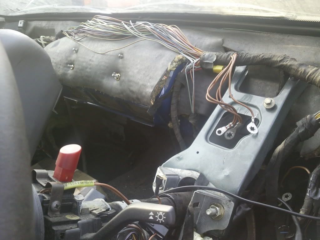

I have done the bulkhead modification for the air con system and tidied up where it had to be cut out to fit

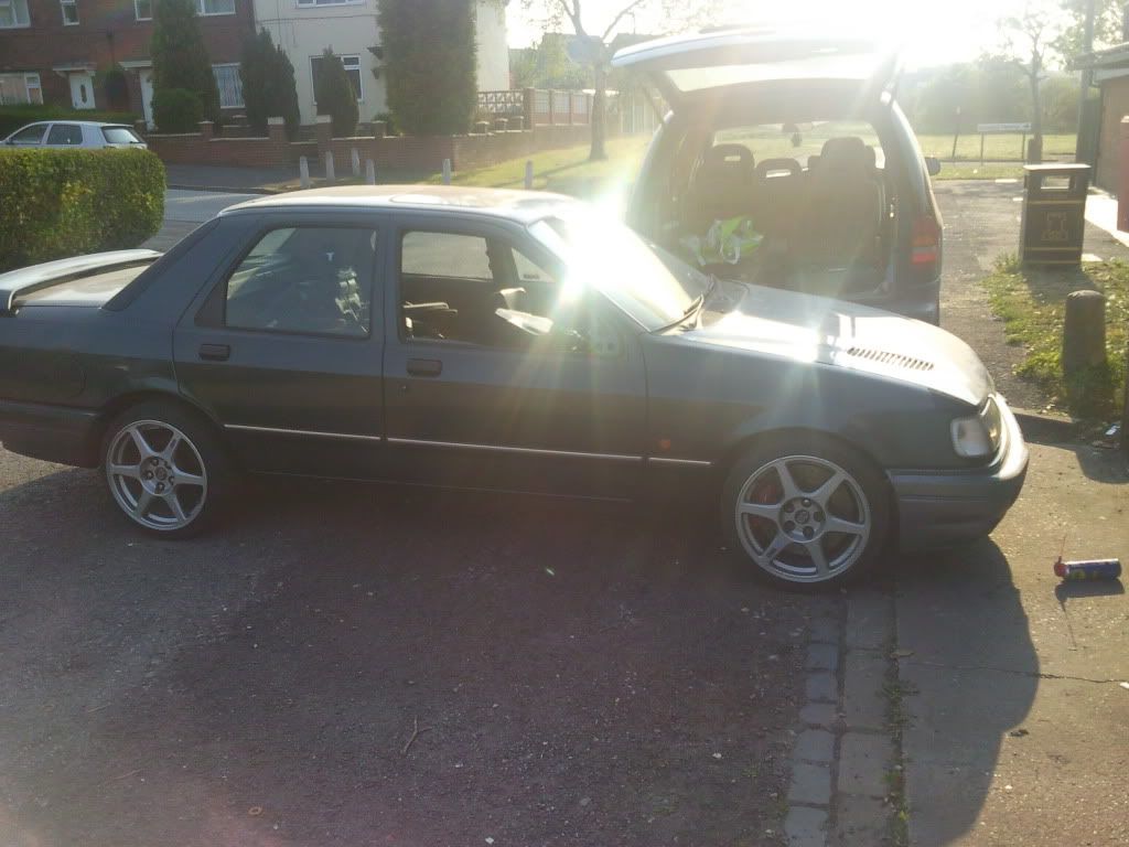

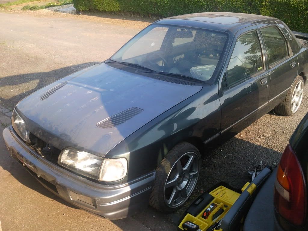

I have tempararily fitted my 4x4 cosworth bonnet and front bumper and this is how it stands at the moment,
Hope you all like the progress. :)
