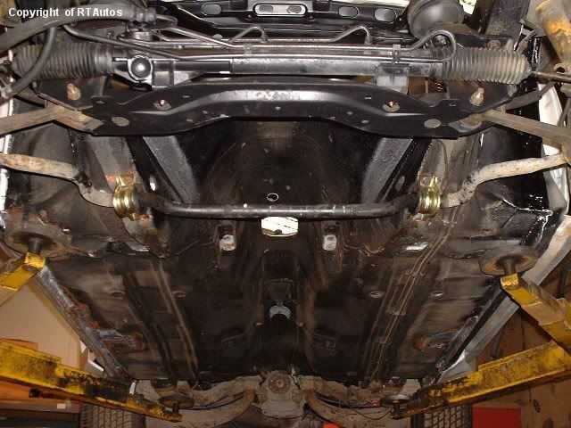

Scorpio 29mm front anti roll bar fitted

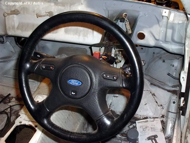

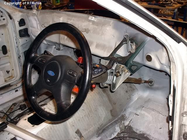

Scorpio Steering column fitted

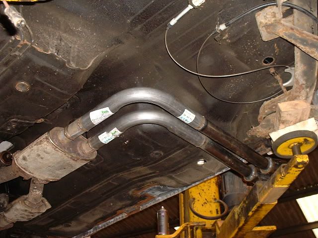

Since then I've finished the exhaust

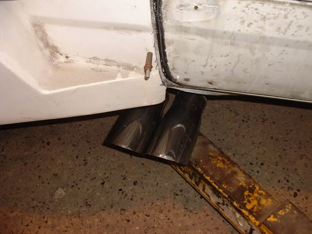

its hardly progress is it - they should design angines with FEWER parts, not more. anyway - thanks for updating this thread - i feel so much better knowing i'm not the only upto my neck in it   The side exit exhausts are road legal are they? might concider that meself if they are - good stuff Taps
#234
Quote from: Janspeedcapri
iThe side exit exhausts are road legal are they? might concider that meself if they are - good stuff Taps
Yes m8
robrs2
Thought about putting mine out one eachside, but don't want it too loud. Anyidea how loud it is with only the centre box?

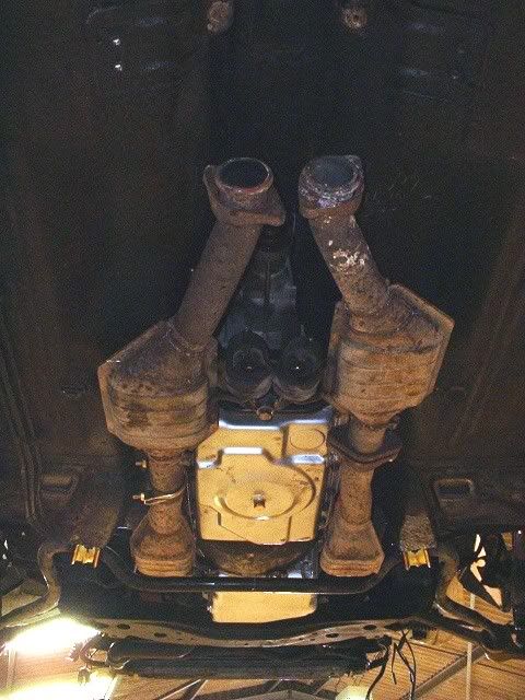

Quote from: Taps
Moved onto my exhaust system from there, all was going so well, cut the front two Cats out the down pipes, cut out the back two Cats out and turned the box's into silencers
You might have to put me right here Rob. As we know that cats hinder performance,therefore it would be better to leave them off. Now,with the manufacturer date of the XR4i being 83 or 84,it would not need a cat test,as it will have 'PR' on the VIN plate for the MOT inspectorate. Whether the V5 will have changed details,it still wouldn't effect the eissions test. I'm none the wiser.
I think they are empty, I think he has details somewhere..
BOB cars are known for decatting themself.
