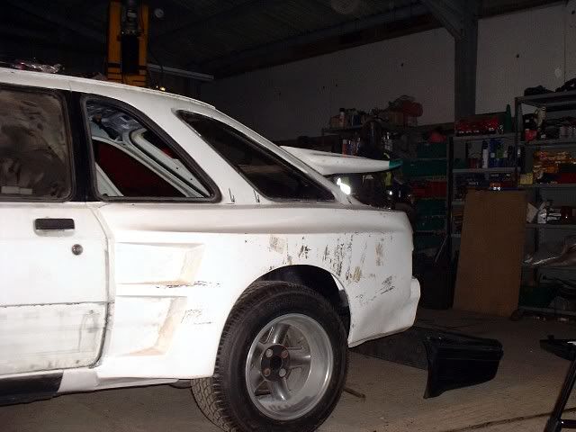

Right into fitting body kit now,  still waiting for 2 new complete front wings from Smith & Deakin due to the ones I took off from the donor car not being up to scratch in the end.

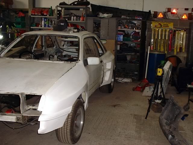

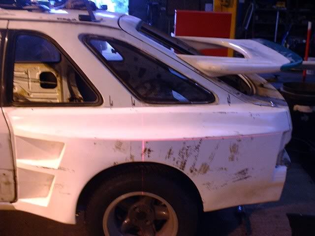

Baz is giving me a hand and we got all techy tonight and got the lazer aligner out    ya can just about see the red lazer lines in the pic's
Going to be a lot of work in fitting the kit.

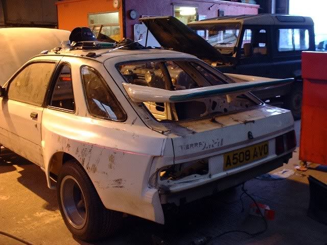

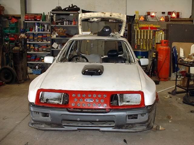

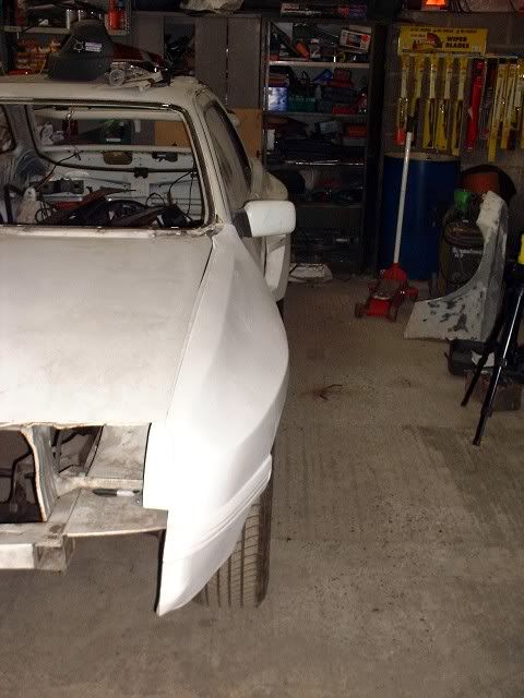

Front wings came today so just had to lay them on there
Todays efforts
Front wings are on still got to re work the bottom front edges to finish then, the bumper part they come with lines up with nothing even if I had the S&D bumper to match the wings it would have sat above the front grille bottom which it shouldnt.

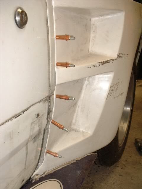

Frank lent me some quick release fasteners which work realy well, cheers m8.

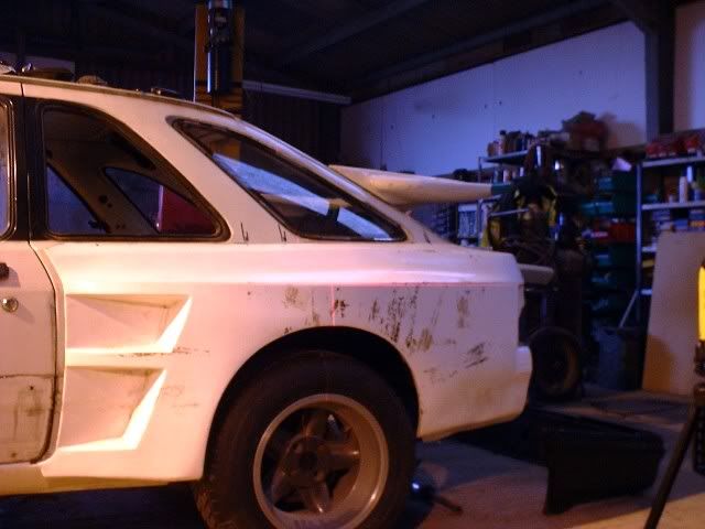

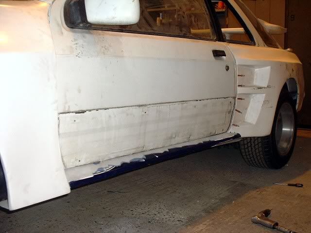

Drivers side low skirt from the old kit fitted after a lot of modding, I was going to run without it but didnt look right

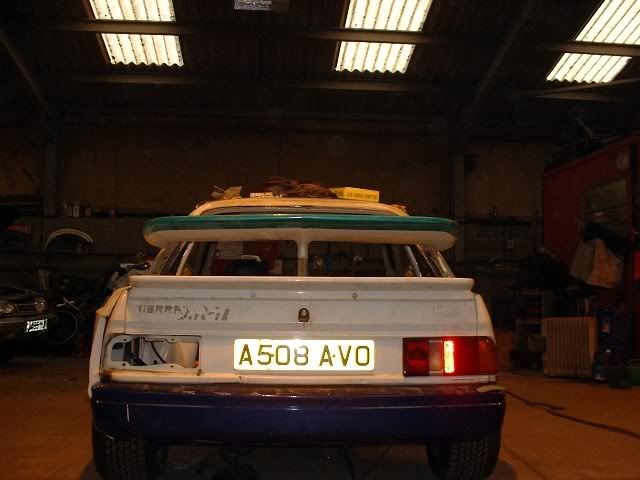

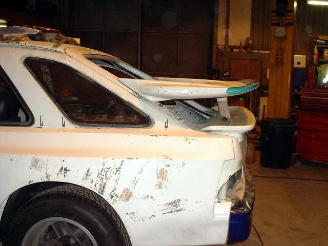

Rear spoilers mock fitted, can now weld up tailgate ready for spraying

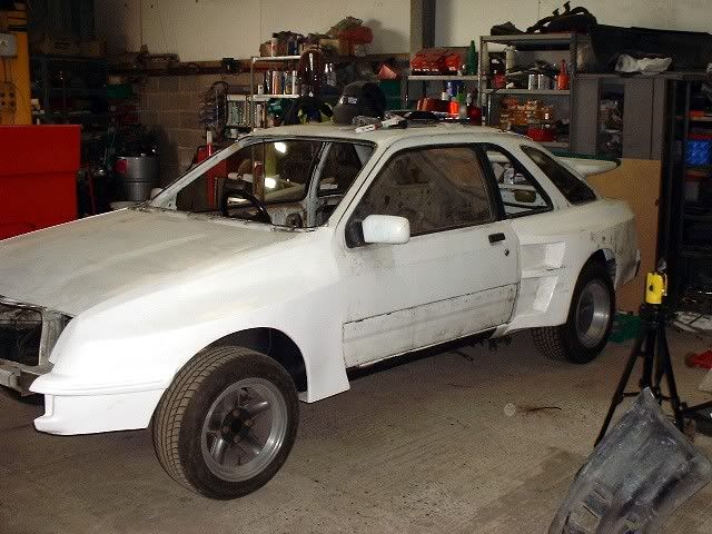

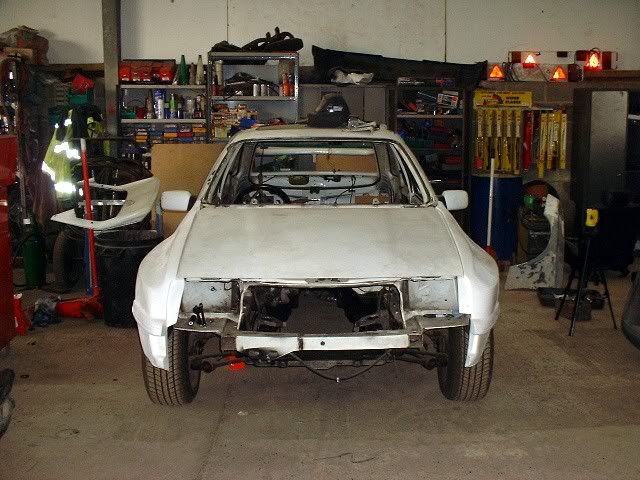

Right have run into a problem tonight, when i fitted the passenger side wing to get the wheel in the centre of the arch had to move the wing back from the door
 will track it in morning and see what that is, still better to find out now . Will have to swop the scorp rear suspension over before i go any further with them.

Right, update on why one side wheel base is longer then the other.
It looked like either the rear wishbone or beam must have been bent or the body was bent with the rear wings aligned with the centre of the wheel and the centre of the arch the wings ending a inch out of line to each other at the door opening.
Last night I put the Scorpio rear suspension on and the wheels/wings still sat the same so it looked like the body was infact bent somewhere as the wheel base on the off side was 2601mm near side 2621, 20mm difference
I took my 4i into work with me today and took the same measurements on that, off side 2600mm near side 2622 mm a difference of 22mm, this left me thinking WTF is going on here, have I got 2 bent 4i's, I also had a customers Mk2 XR 4x4 in for service today so measured that, off side 2612mm nearside 2631mm difference of 19mm
Again WTF, now the chance of me having 3 bent sierras at the same place and same time must be slim or am I realy that unlucky   , plus I've had my 4i 4x4 on the rollers twice now with no comment that it was running out of line, so done some digging.
Autodata give the wheel base as 2609mm, well all 3 werent that so dug out my Ford Mk 1 Workshop manual , found a nice Frame Dimension sheet and it would seem that no Sierra body was built that straight to begin with  ,  two ref points on the body 1 just in front of the front strut turret to the centre of the rear shock mount allows + or - 30mm   so 20mm  seems to be feck all to worry about
Allowing also for slight differences in the fibre glass wings I will just have to get them as close to each othere as I can.

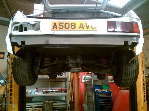

Fitting the Scorpio rear suspension  with 7 1/2 inc lsd diff to the 4i.
Simple bolt on job, not really, the beam is a direct fit, but the shocks cant be used as there to long

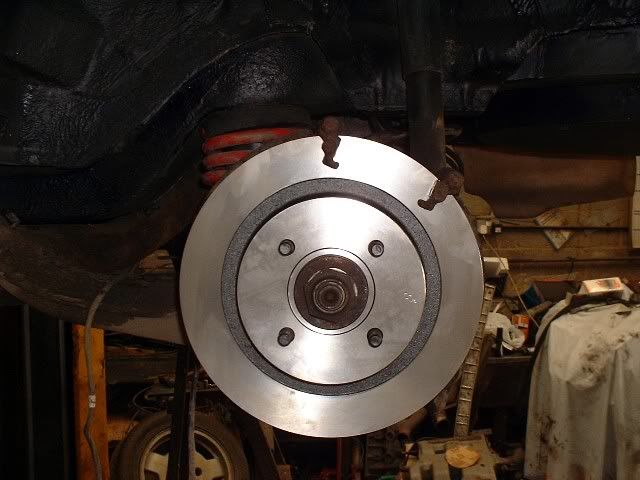

Wheels and brakes.
If your keeping the 5 stud Scorpio wheels then there not a problem.
If you want to stay 4 stud then you will need other bits, first off the hubs from the drum system will not fit the disc brake set up, so you will need the 2 hubs from a rear disc brake Sierra, there a direct fit into the Scorpio bearings.
The Scorpio rear brake discs are 5 stud vented 273mm dia, need to change these to the cossie 4 stud rear disc's, again there a direct fit.
Had Brake cable
The scorpio one will not fit as its to long, so need to fit one from a rear disc brake Sierra.
Will update with more pic's as I change over.

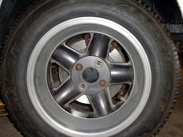

4 stud hub flange and the cossie disc are on one side, along with new flexi and steel brake pipes.
glyn
Are u going to put spacers on your wheels Taps ?....glyn
Quote from: glyn
No Glyn, they stick out the archs far enough now
By the looks of the wheels they are the correct off set for the axle as the centre is still in the centre of the hub.
