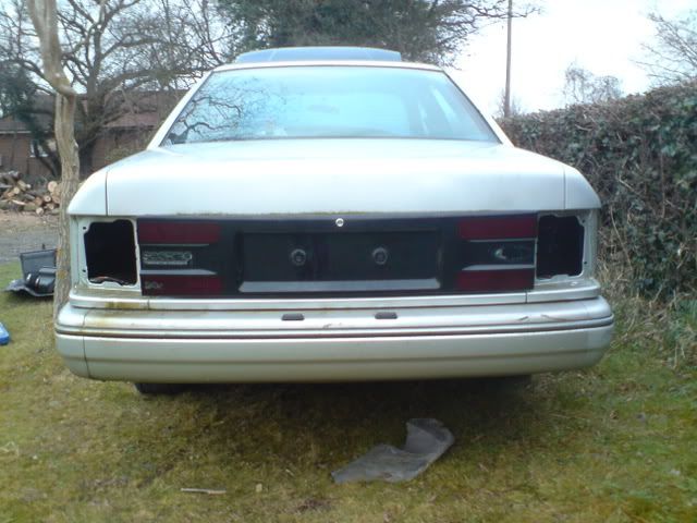

Ok, just recently i purchased a rolling shell to start my conversion. The car i bought is a 1989 Rs Cosworth rolling shell. Engine, gearbox, prop and diff had all been removed aswell as the leather. This is how it looked when we picked it up....
