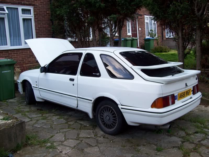

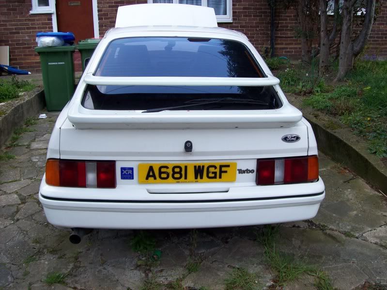

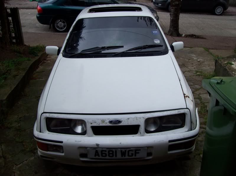

well......here she is
84 A xr4i , the last owner put a turbo technics kit on. the t200 ? does anyone know this car? ive left reg plate on pics.
what it needs after 1st quick look is
welding, surprise surprise....lol, both rear arches, it needs a slam panel, nsf wing,are all mk1 wings the same ? all underneath is solid, the a pillers have bubbling rust,sunroof and roof panel all seem fine. need an alternator and battery. the last owner put power steering on as he said 84 cars didnt have it ? i dont know? he took it off his 83 car. are the alternators different to run more belts? im thinking they will be...anyone got a part number?
it came with genuine cosworth rear hatch and wing,bonnet, front bumper which needs fixing and refitting,
sapphire fr+r cosworth seats,3door cosworth alloys. and lotsa spares, wheels,dash e.t.c
plans are front and rear cosworth running gear,brakes,suspension e.t.c
3 dr cos arch's and skirts
cage and a pair of buckets
a lot of work,but should be fun..  lee
Bit of work m8 but then hard to find one these days that dont.
You cannot get 4i wings even pattern ones, you can get Mk1 wings but the side indicator holes are in a slightly different place and your need to drill the holes for the cladding etc but they will fit.

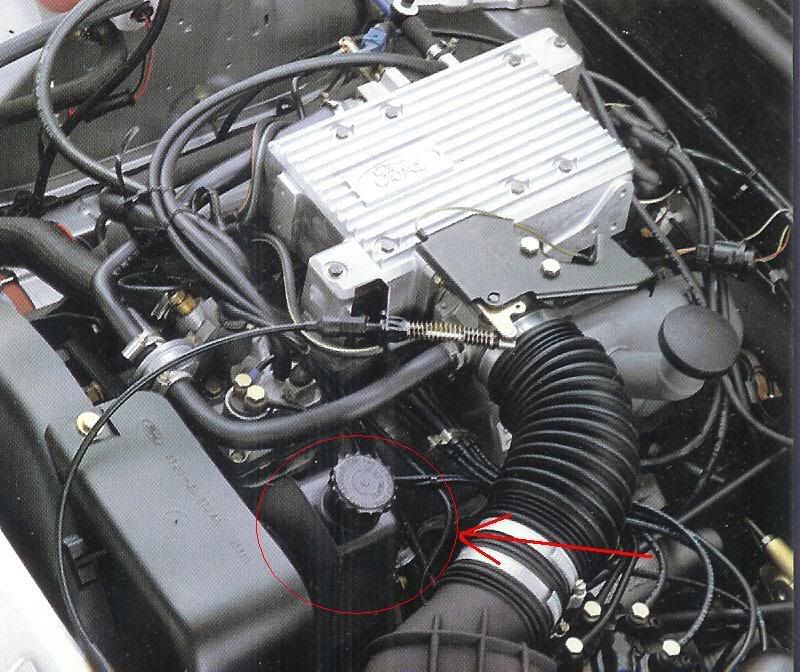

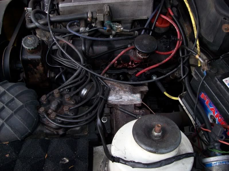

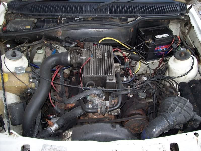

Not acquainted with this kit version,but does it run ok?  Hopefully it will have the TT distributor,because somtimes not all the parts that have been on offer have everything needed. Can you do a picture of the engine?

Quote from: yorkshire ripperthe last owner put power steering on as he said 84 cars didnt have it
Not all XR4i's had PAS,but it was on offer as an Optional Feature at a cost of £388.26 adding to the price of £9656
Hopefully the reservoir is there

thanks for your reply and i'll get an engine pic up asap.

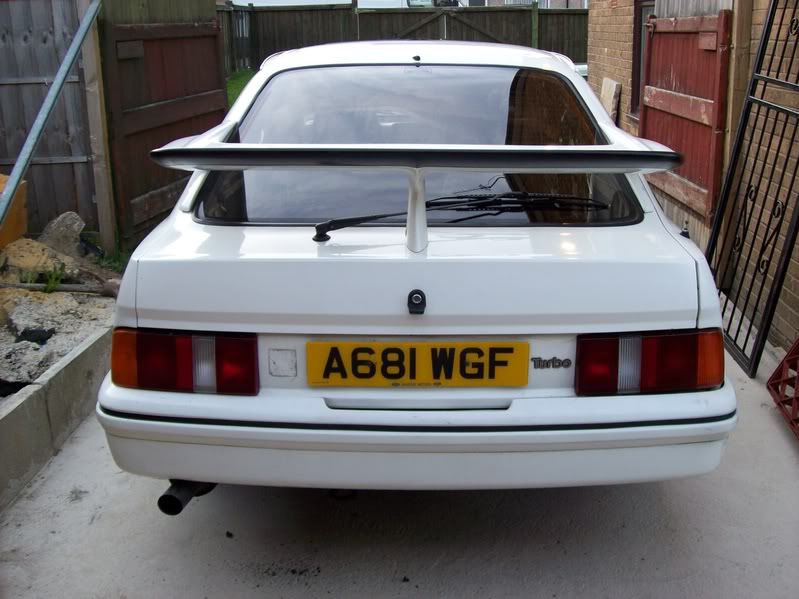

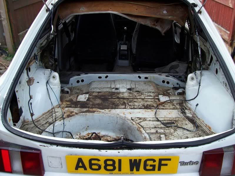

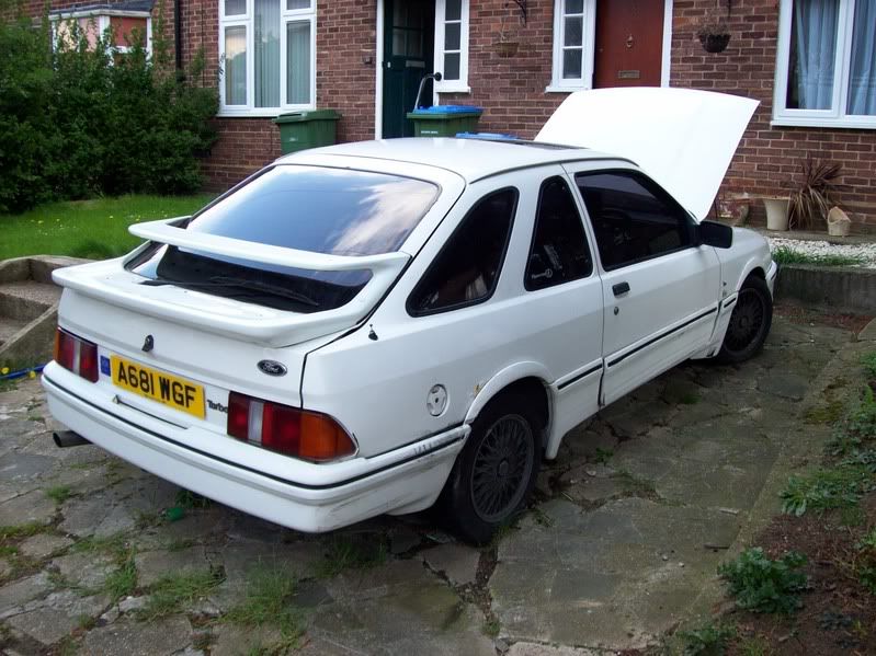

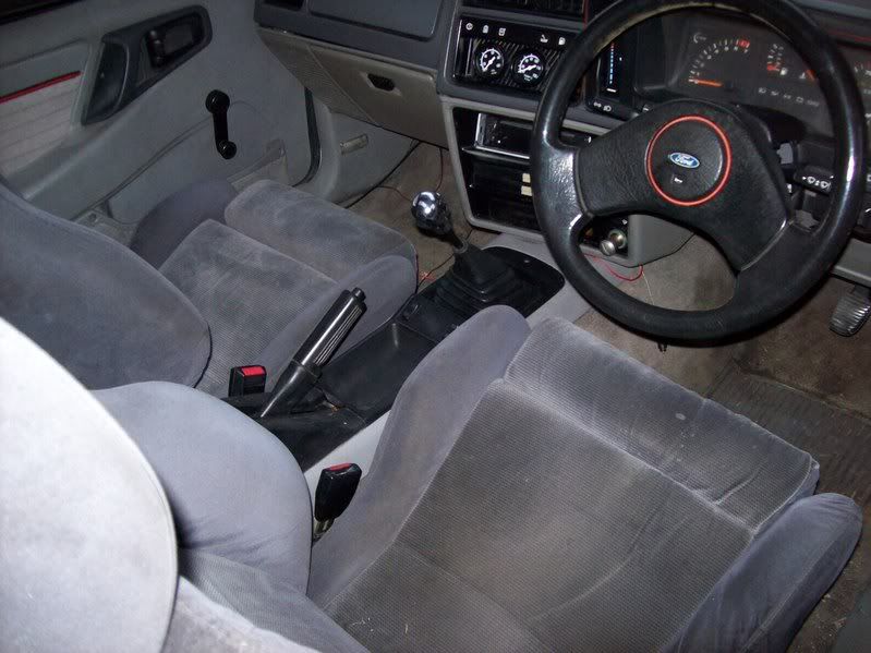

well..... got a spare few hours today so rolled the old girl out in the sun and started stripping the interior and trim out of the rear. took the xr4i hatch off and fit my cossie hatch, i know theres more important things to do but i couldnt help myself.....
tomorrow will be...... front seats,carpet,door trims and roof lining out then a good scrub inside to see what repairs are needed.
i think im gunna change the engine and start from scratch with a sierra cosworth engine and box i can have from a mates car cheap!
here's a couple of pics from today
lee
