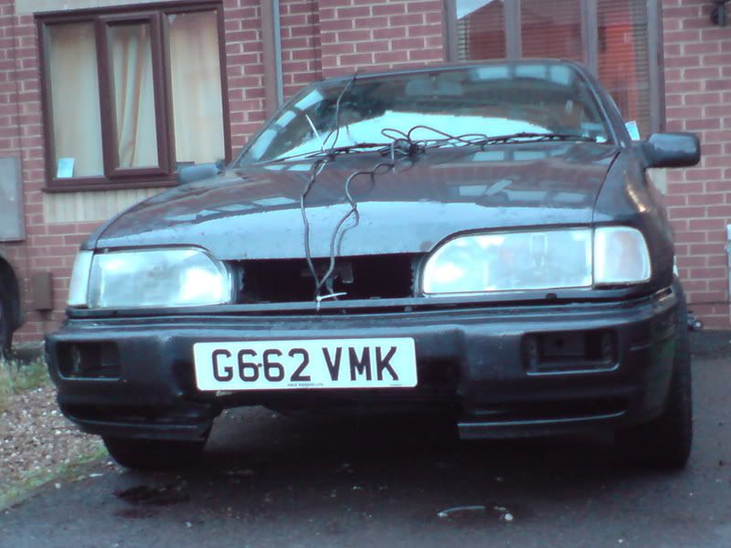

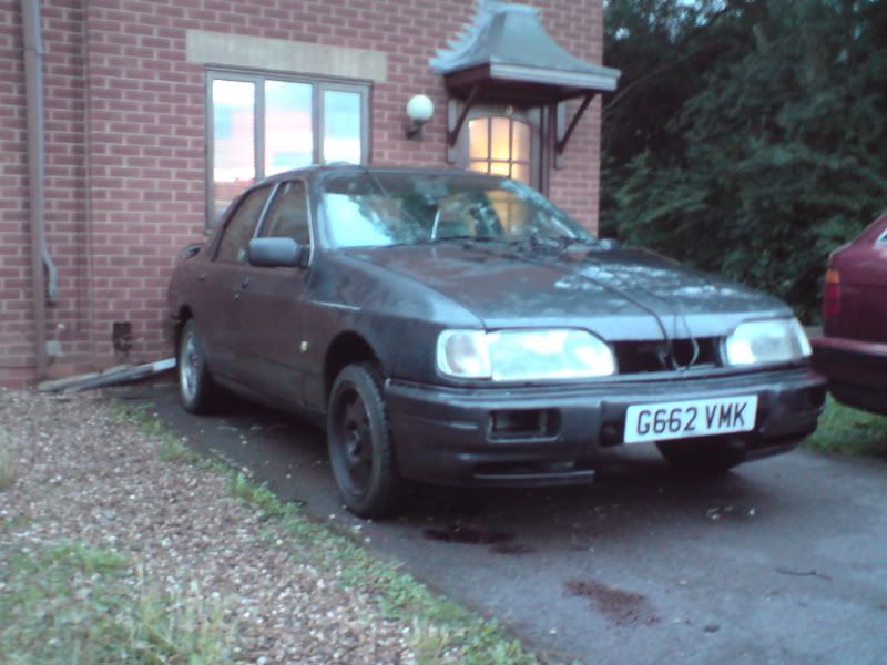

So on Monday night I picked up my project car. Bought from Tom (Doughnutter). It was a G plated 2000e, but when Tom bought it it already had gone through a 24v transplant, Tom has kept his engine and having back all of the running gear so that i can put all my stuff from my old 4i 24v
So here it is when I first got it

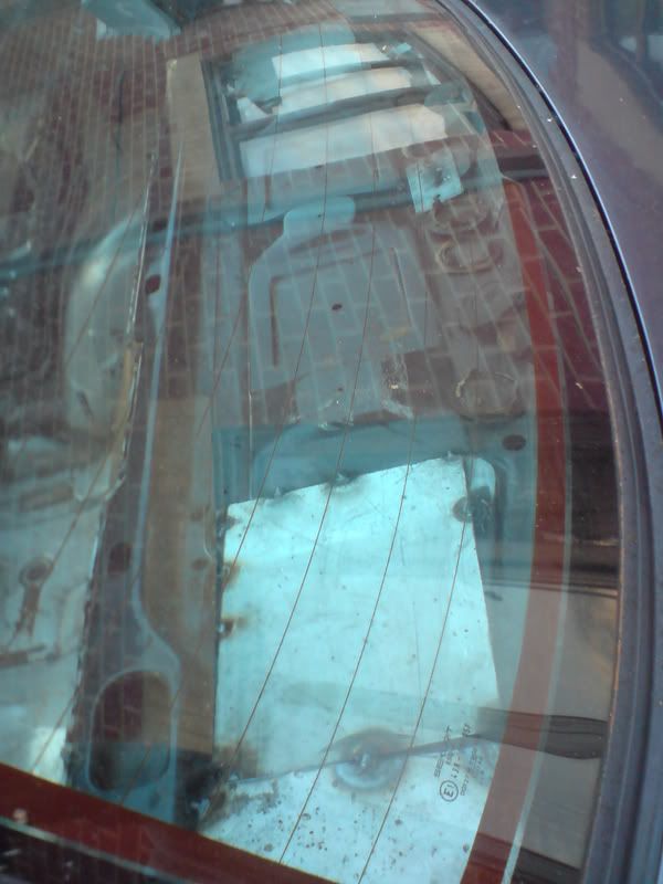

Tuesday nite I started stripping the interior
Before
After

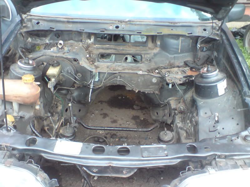

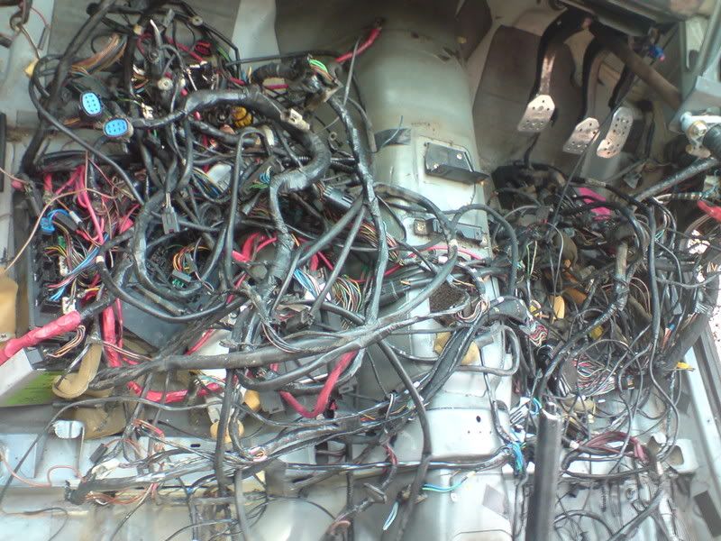

Plan was to keep the loom that is in the car but after looking at the mess of wires in the passenger footwell I've decided mine is a lot simpler and tidier
Wednesday involved more striping last nite, first thing was to remove this spaghetti of wires
Much better

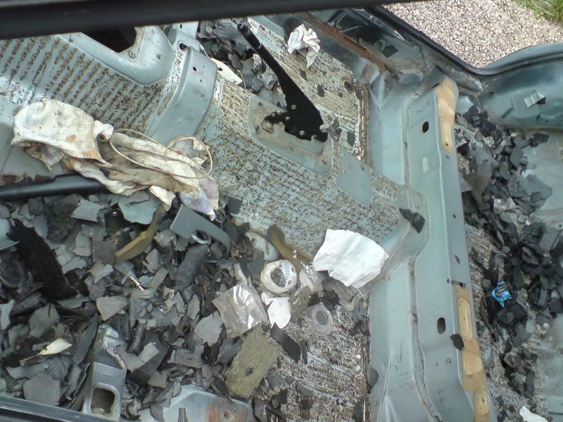

Tonite I've done little jobs, first off I took a trip to the tip to get rid of the e34 touring bootfull of crap that I had already stripped from the interior and under the bonnet, whenI got back I cleared the engine bay of all the bits left bolted down ready for a good degreasing.
I also got rid of the door cards, seirra owners out there any tips for getting rid of the horrible black stuff that sticks the foam shite onto the door? I gave up and left it on my old one but want this one looking nice and clean..
Other than that I removed some speaker wiring and the wiring in the boot for the solenoid boot release.

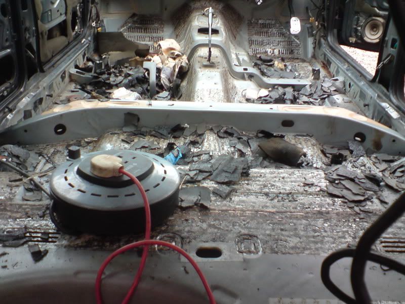

On the weekend I tackle the sound deadening, luckily I still have the heat gun I borrowed off the in laws to remove it last time, best give it back once I'm done

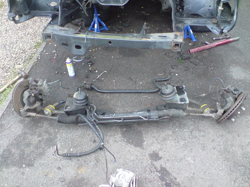

Once thats done I will remove the rear sub frame and front cross member and all its attached bits to give them back to their owner.

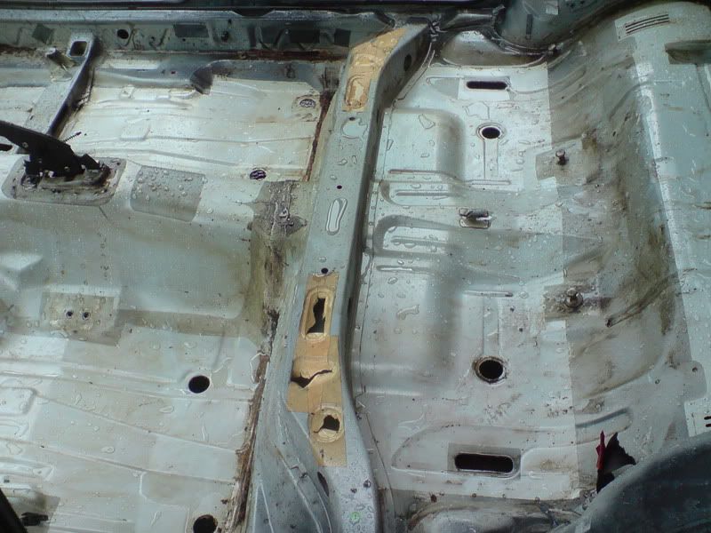

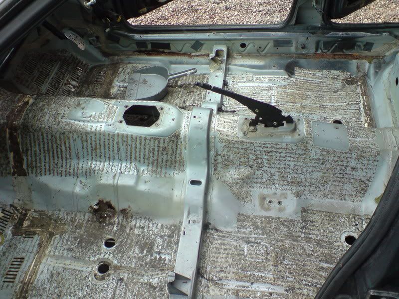

Today I've stripped off all the sound deadening, I'm glad that I still had the heat gun as it all lifted of nice and easy
After I had bagged it all up I started working on removing all the residue left over, thanks to Toms tip I used petrol and a paint brush then wiped it of and it all just lifted off.
Before
After
Now the interior is nice and clean after a wash down with the hose, means that I can start attacking the few rust patches and install my roll cage then paint up inside  :cool:

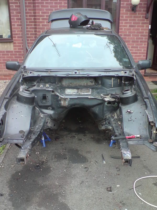

More stripping on Sunday, as I'm using all my old stuff I'm giving the front cross member and rear subframe back to Tom

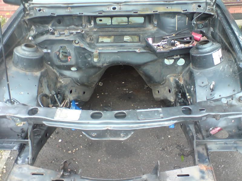

So now everything is stripped it time to start rebuilding, first on the list is to break out the trusty welder, there's a patch on the passenger side of the transmition tunnel that needs patching and this inner sill to floor have atarted to go in a few places inside, I've also got a few unwanted holes in the bulk head that the BDC reg require me to block up....

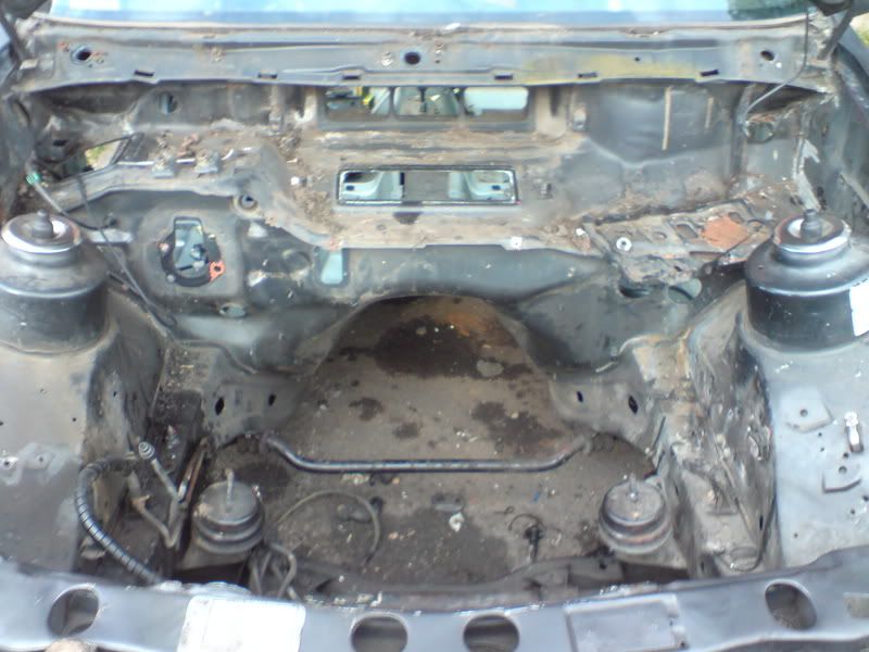

Managed to get some stuff done most of last week involved cleaning the engine bay, btw cheap ass washing up liquid is great for cleaning off all the grime and oil in the engine bay, I also managed to prep the rusty areas, mainly by chopping out the big pieces and treating the smaller patches with rust treatment.

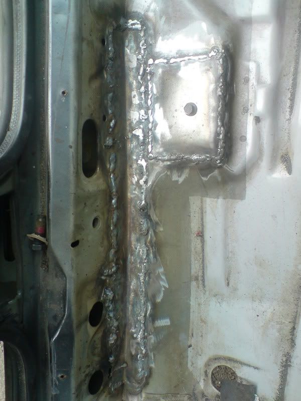

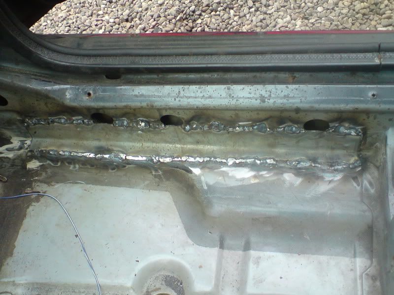

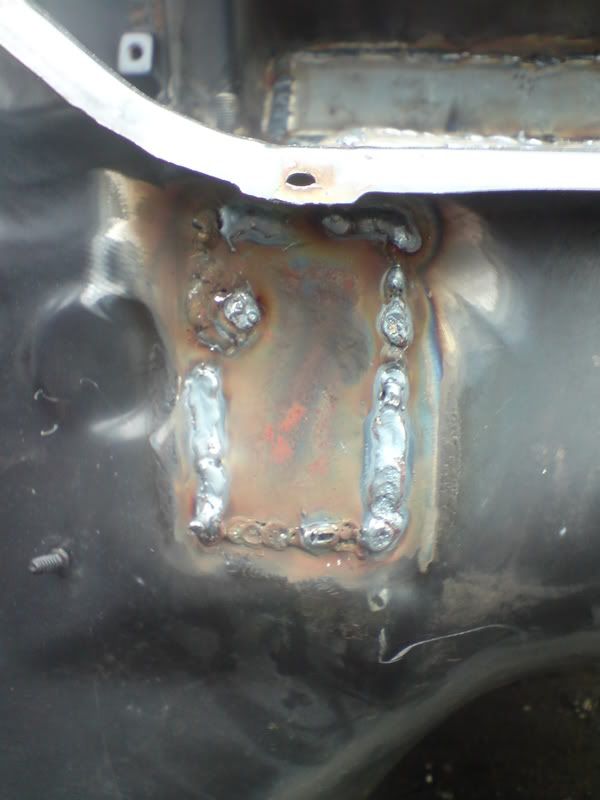

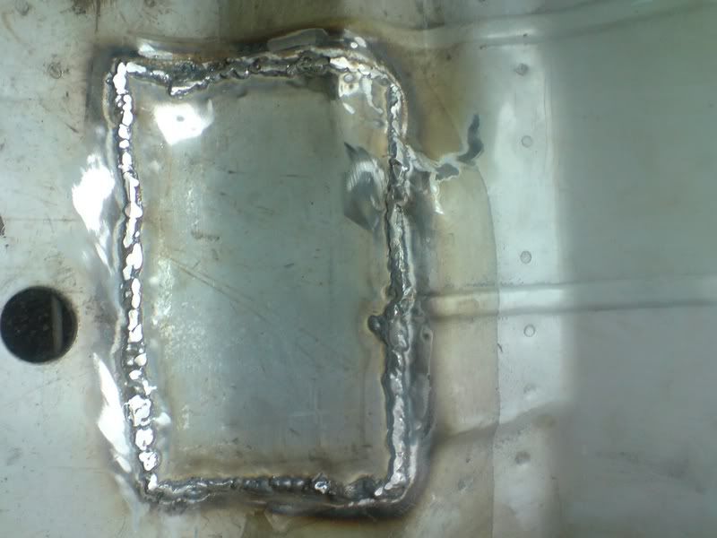

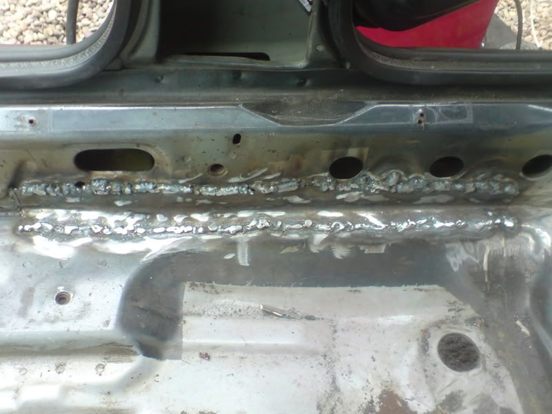

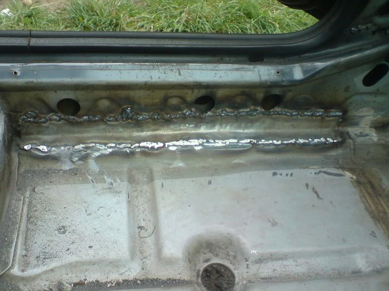

On the weekend I got the welder out:

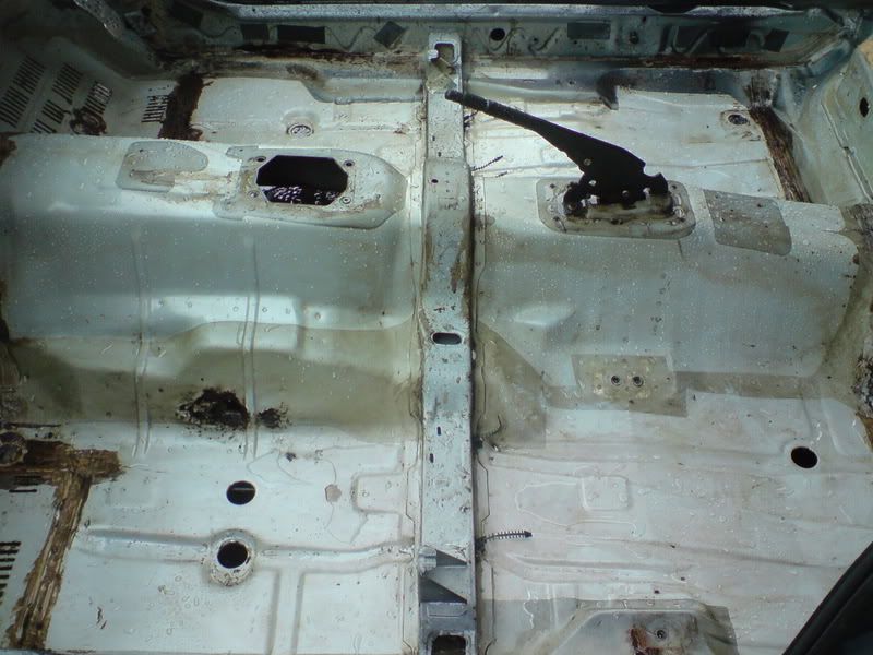

Patched the inner sills where they had started to rust away
Also the passenger side rear outer seat mount needed some work

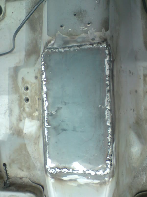

The transmittion tunnel on the passenger side had rusted through
I patched this underneath with 3mm plate where it had gone through the double skin and it was near the gearbox mount then dressed it inside. Debating if I should drill some hole anf plug weld them together, but doubt it'll really add strength.
Also cout out the old handbrake mount to make a nice flat section to mount the hydro, used 3mm plate again to make it nice and strong

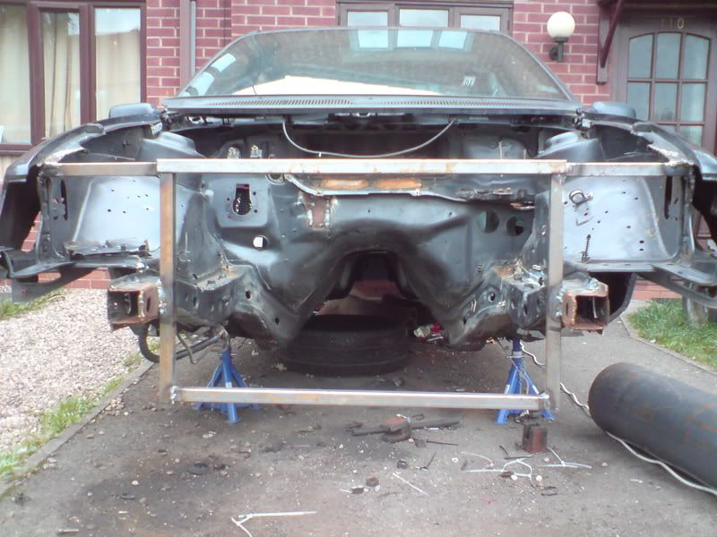

Then I got bored of welding, I've decided to try and save weight at the front I'm gonna make a box section front end which will have a removeable part to aid installing and removing the engine and also have a radiator protector built in to save me from those nasty cones so I took the angle grinder to it.....
Weather was shite on Monday nite but I got home from work today and the sun was out so I set about making a rear firewall so that I can install a boot mounted fuel tank, I ended up with this before it poured down

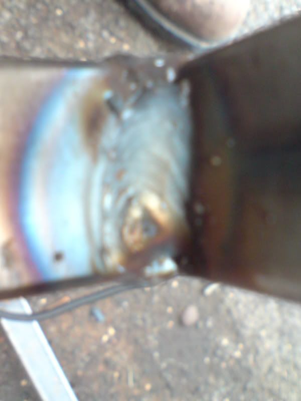

Dont be too harsh with my welding skills I know they aint great but I still got my L plates and trust me the inner sills in the sierra are like paper, I'm getting better I think...

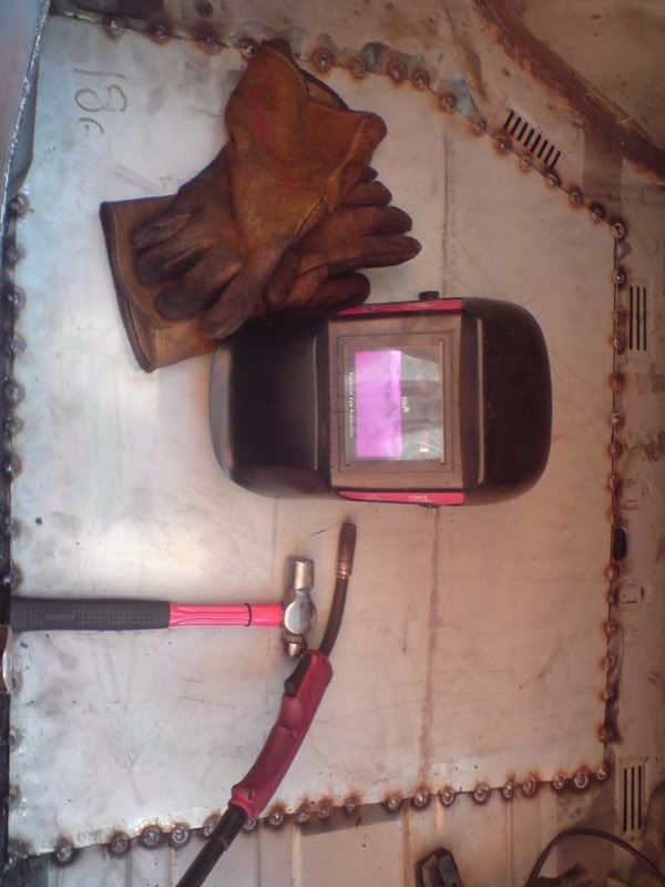

Right another update for you, things are still going slow what with the Derby weather recently and the need to use power tools outdoors but work is carrying on when I get chance out there.

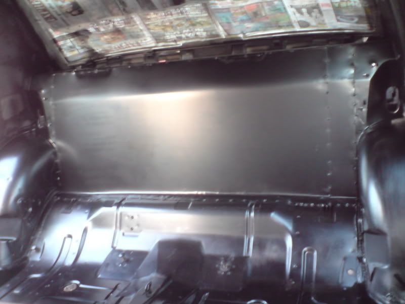

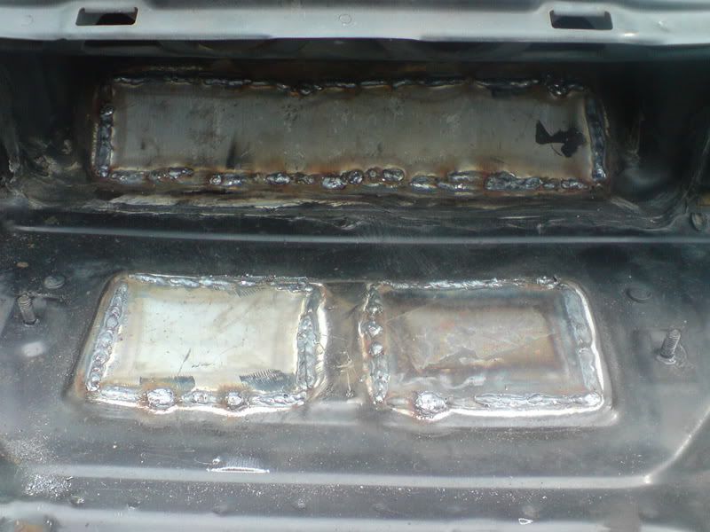

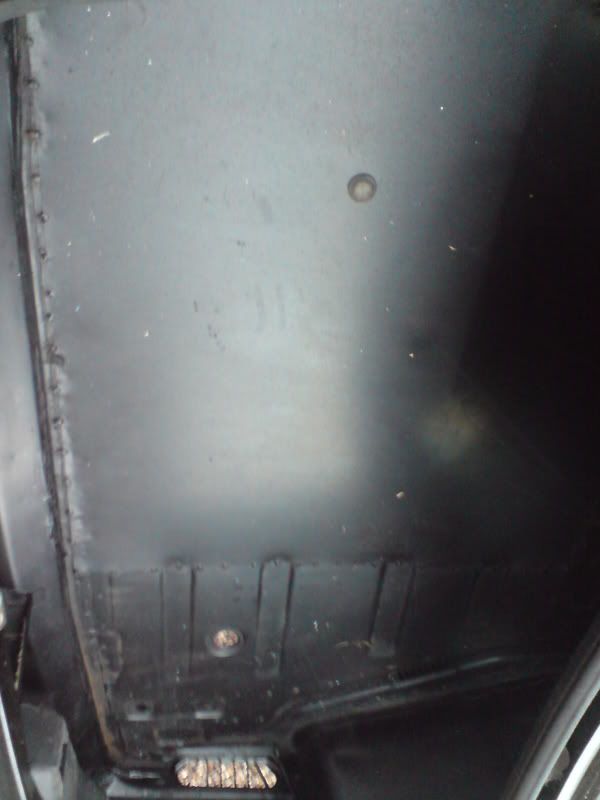

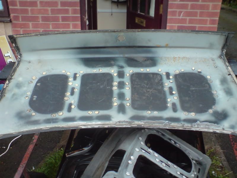

In the last couple of weeks I have cut out the spare wheel well and welded in a sheet to cover the hole and give me somewhere to mount my new shiny fuel cell
I have sprayed the boot black, well most of it the rest I couldn't do without getting gassed
I have cut the structure out of the boot to save some more weight

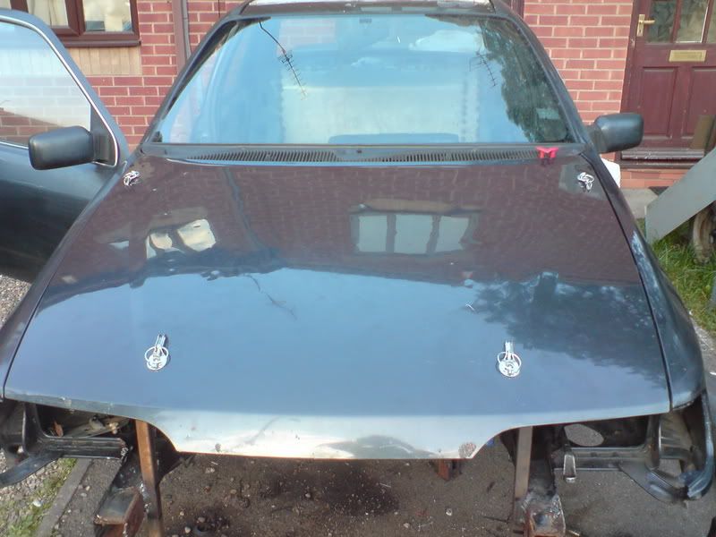

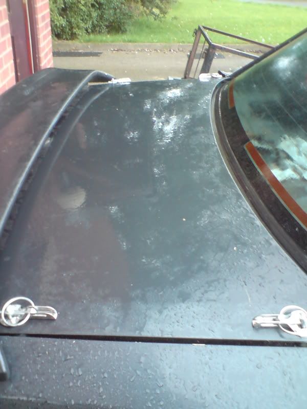

and I have put bonnet pins on the boot to make it accessable without a key as the rules of BDC state

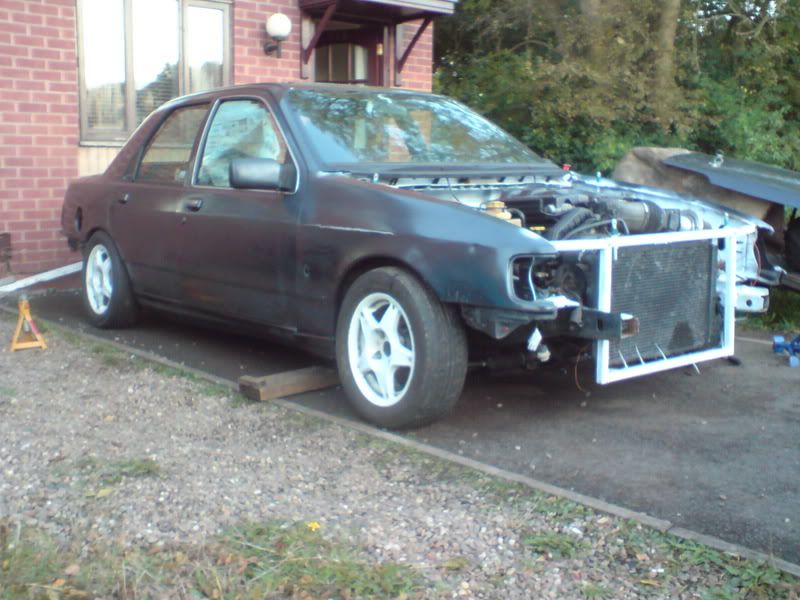

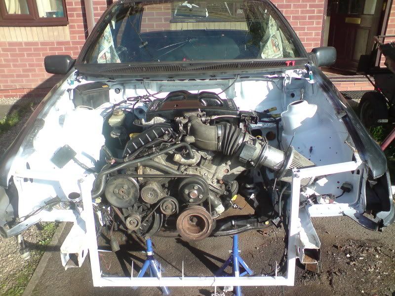

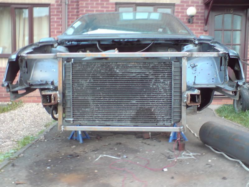

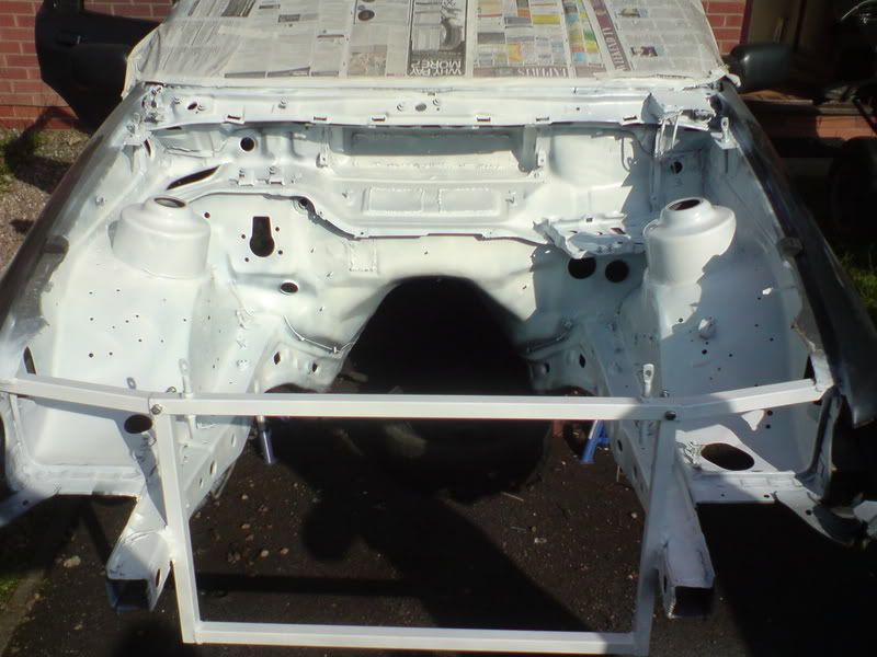

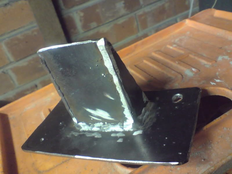

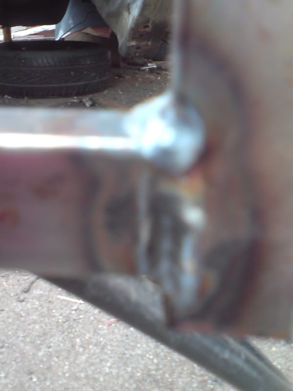

Finally I get a dry nite to break the welder out properly, so I set about making the box section front end
Some pictures of my welds, camera kept wanting to focus on other things though.
And here is the finished article
And doing what its made to do
Protecting the radiator which is in a fragile place, I'm happy with it and it looks pretty tidy too  :D

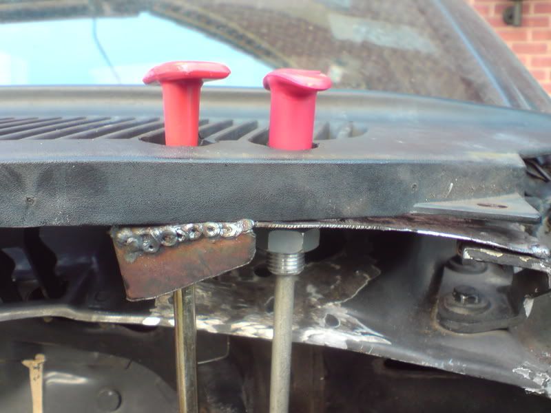

I've had another hard evenings work, the pull cables are mounted
the bonnet is pinned

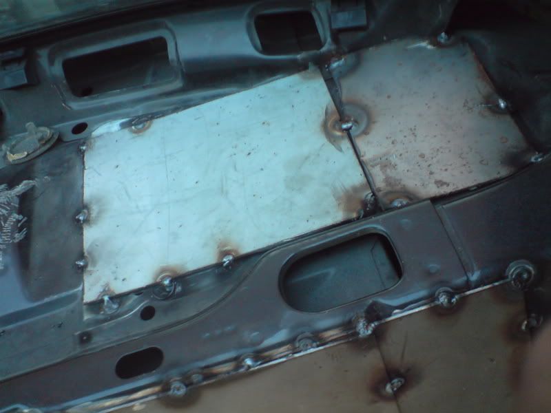

and the big holes in the rear shelf are covered

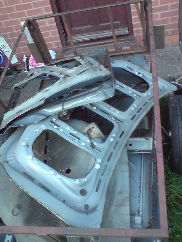

Here's the trailer full of scrap metal that I have cut out of the shell
That means that most of the welding is done, leaving me now with some tidying up to do, painting the interior, painting the engine bay, refitting the loom and dash etc.

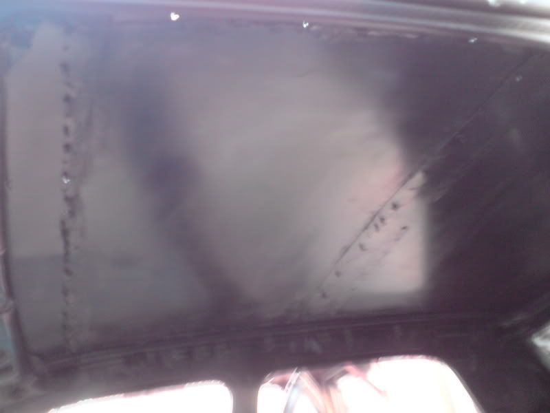

Had another busy day today, wanted to get all the bare metal painted so that I can be happy to leave it for a week while I take a well deserved holiday.
First thing this morning I got to work with a pressure washer to wash off all the muck that had been left over, very successful all th shite was removed.
Left that to dry in the sun while I got on with some other jobs (pressure washing the patio to keep the missus happy, lol). Then I rubbed down the engine bay and gave it a nice new coating of Tetrosyl White, now it looks freaky fresh  :D

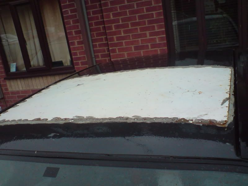

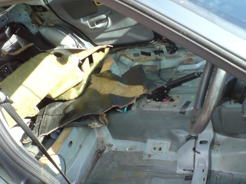

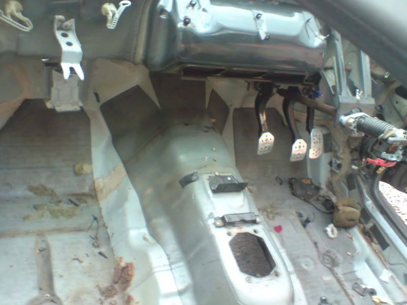

Once that was done i decided that there was enough time left in the day to crack on with the interior, so that got rubbed down, the windows got masked and the Tetrosyl Black cake out, three tins later and my thumbs are very sore but the interior looks good
The rear half
and the roof
I will admit the interior isn't completed as I run out of paint, I still have the footwells and the doors to do but all of the new metal is now coated.

Last weekend my dad brough me back my gearbox with fresh new synchro's and new oil seals, so whilst I had his time i got him to help me put the engine back in and get it running, however he put his fat ass through me screen and now owes me a Sierra heated front screen
Engine in place
the gearbox is also in place

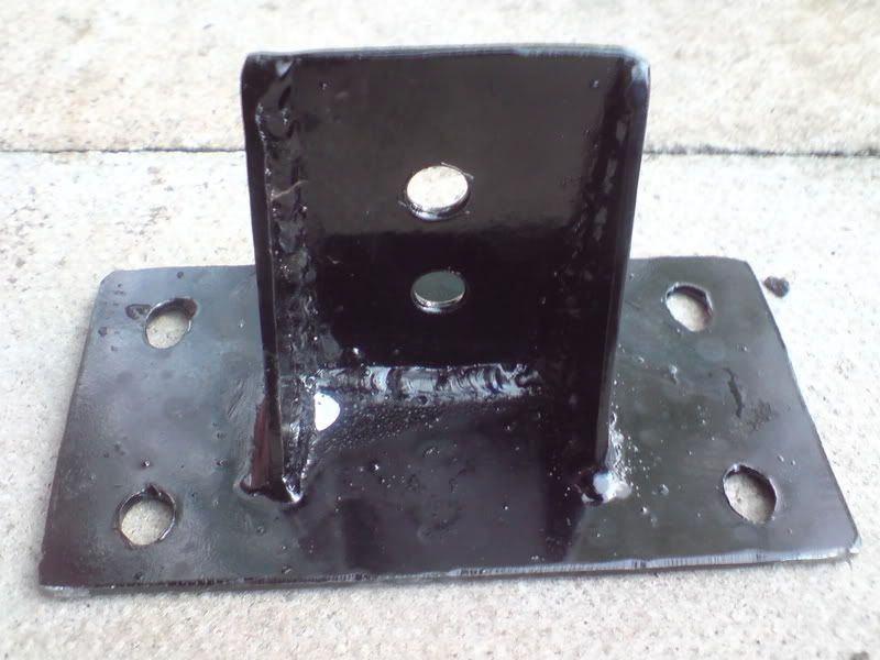

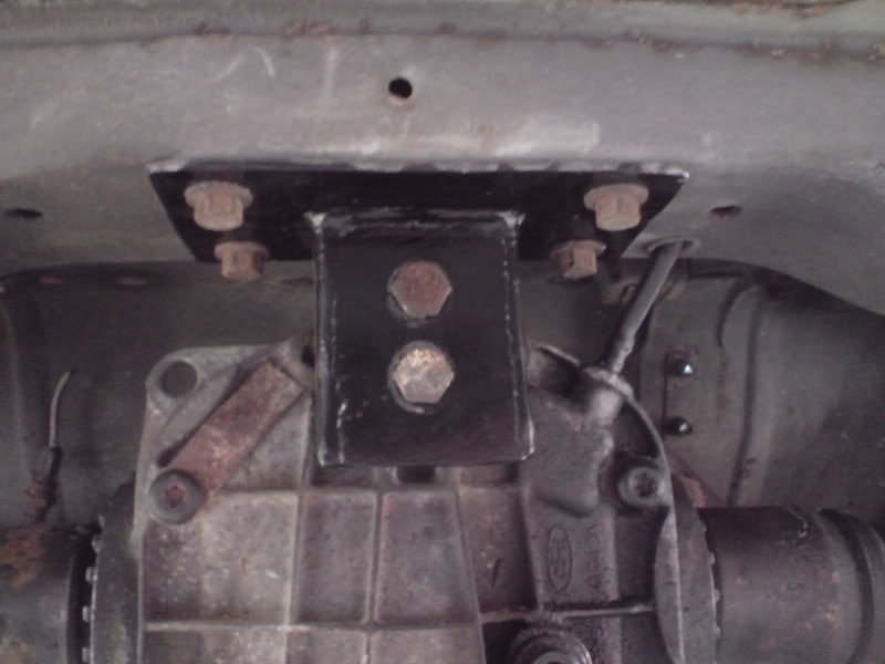

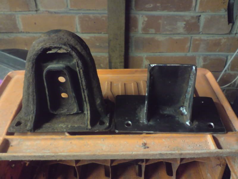

The diff mount got killed after I polybushed the rear subframe so there was no way I was paying £100odd for a polybushed diff mount so this week I knocked up a solid one
with a coating of paint
mounted on the car
If anyone is interested in a Sierra solid diff mount they are for sale at £30 each, for track use only

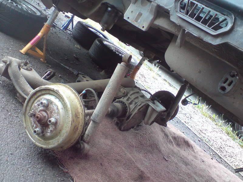

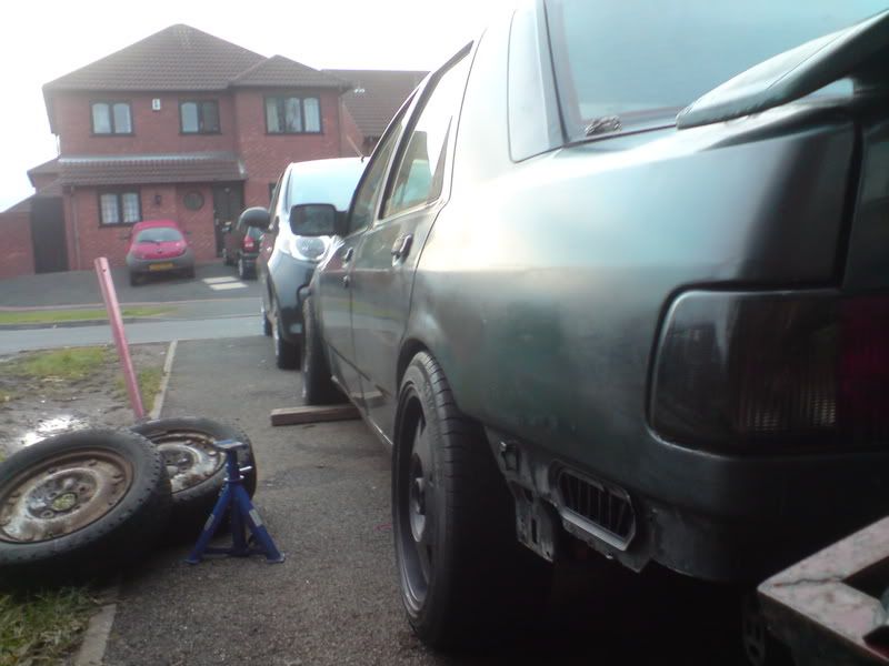

Spent the afternoon re-assembling the rear subframe as I had dismantled it for storing and put it on the car along with the rear shock and springs, which I removed another coil from the back before fitting them
Finally its a car and its on the floor but no way low enough, think it needs about 2/3 coils off the front and 1/2 coils of the rear

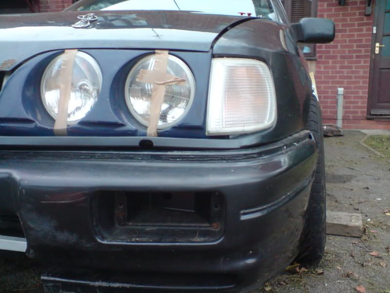

some pictures

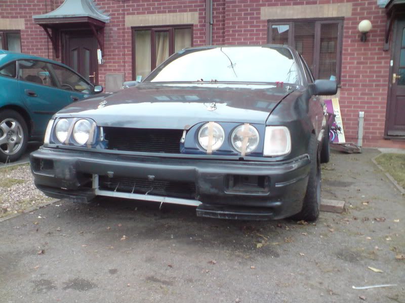

fitment
lights fitted and bumper, dont like the way its been cut by the previous owner
oh and its too high!!!
