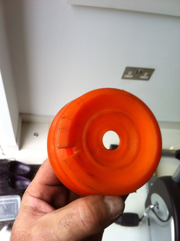

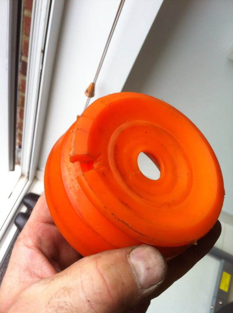

I will get some vibratechnics Mounts then mate I have noticed today the floflex top mounts have a crack in them, this is getting pretty annoying now f##king  floflex ! Yep his dipstick fire was what made me get mine fire proofed in stainless lol my box mount isn't the same as on a 4x4 so may sell em £1 lol

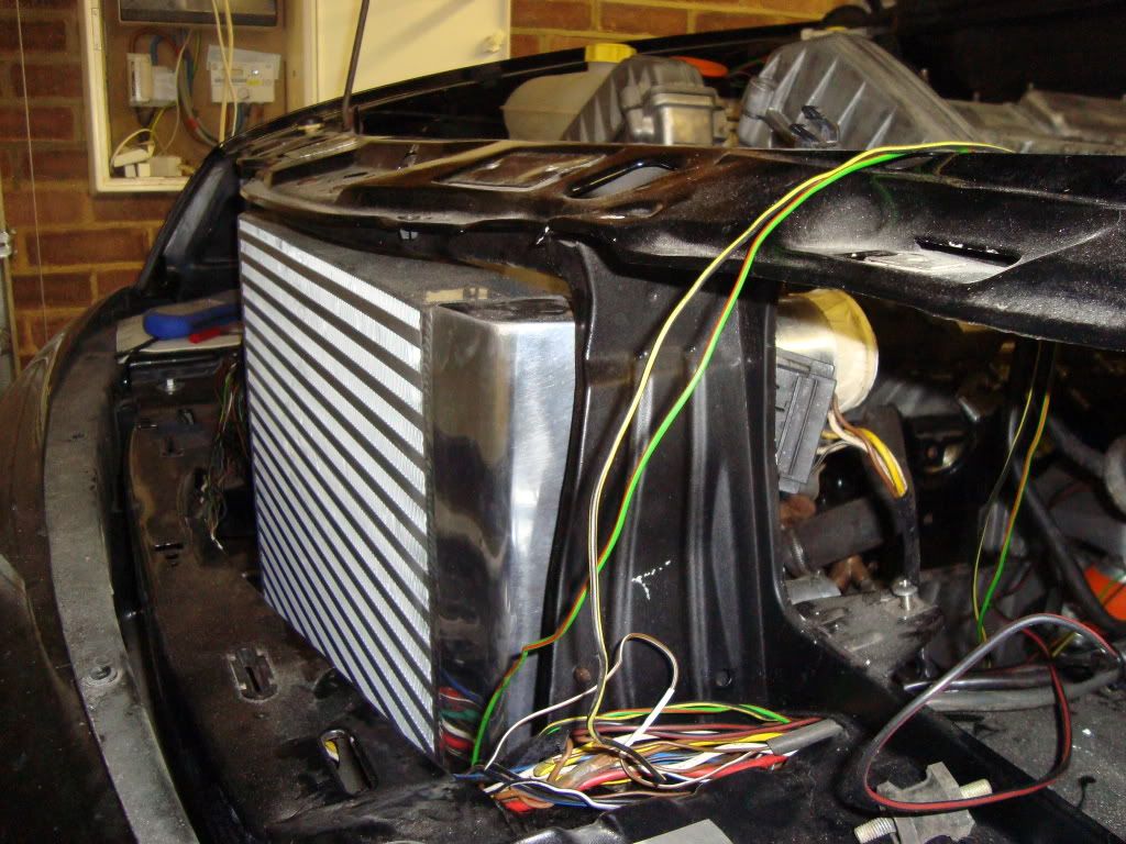

Still no cooler from Spec-R, after being kept waiting all day for him to say no ( and me loosing a days work also )I have decided to get it set up without. Graham has kindly spoken to emerald and booked the 20th of next month (cheers mate). So a few bits to do re road speed etc then D day.

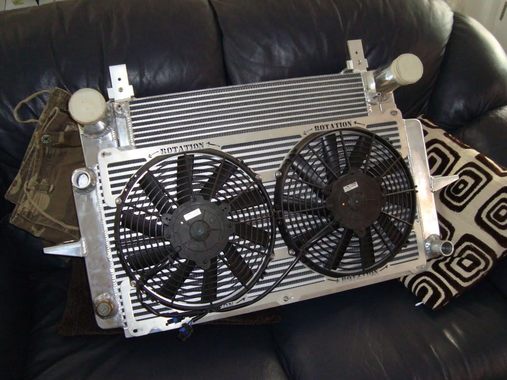

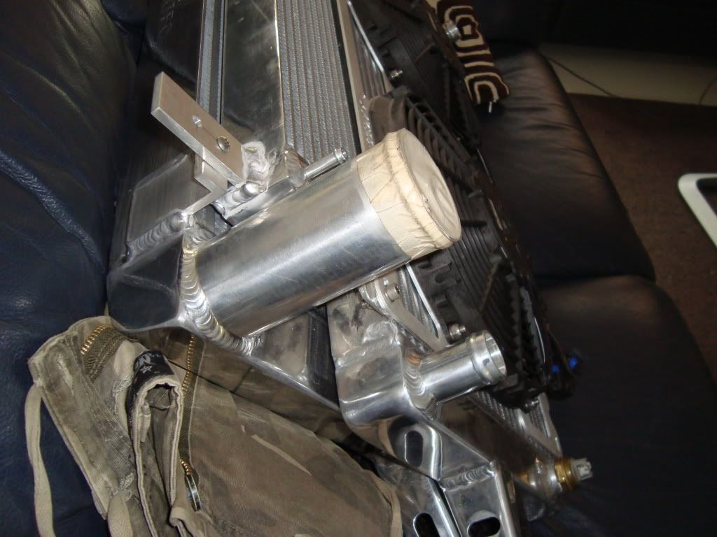

Do you have a good picture of the cooler fitted on it?

yep here is a few
Its an Airtec 70mm one, what do you think ?
Cheers Ade

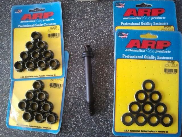

Well I got the stud kit off Mikey at boost, they Graham did some research an the ARP nuts and washers and even kindly ordered them. (still owe you mate I haven't forgotten)
I stripped it all out ready but then Gray gave me a hand to do the swap. Up till 4.20 am not easy to do in place and then poor Gray had to drive home  :-[

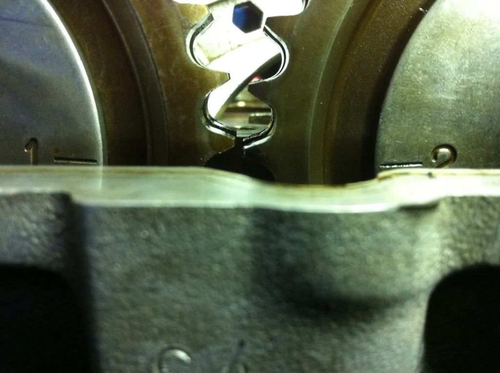

Then in the eves this week. Double checked the timing all lined up
Then put it all back together and ran it up  :P so far so good and took it for a drive and still ok  :mellow:

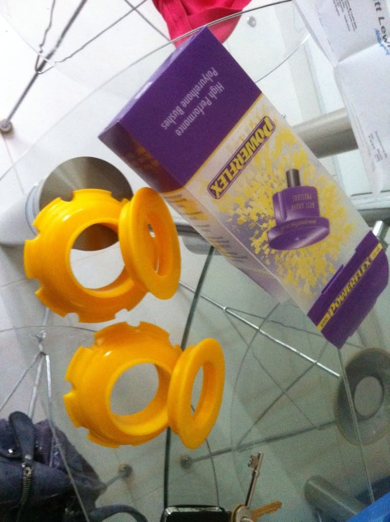

The floflex front top mounts
I think we need to let people know how bad they really are  :'( I am very dissapointed to say the least.
Got some new ones and fitted them

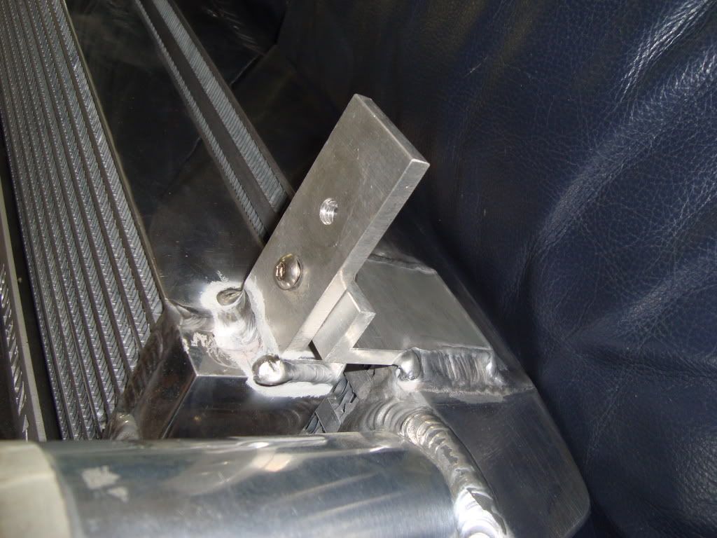

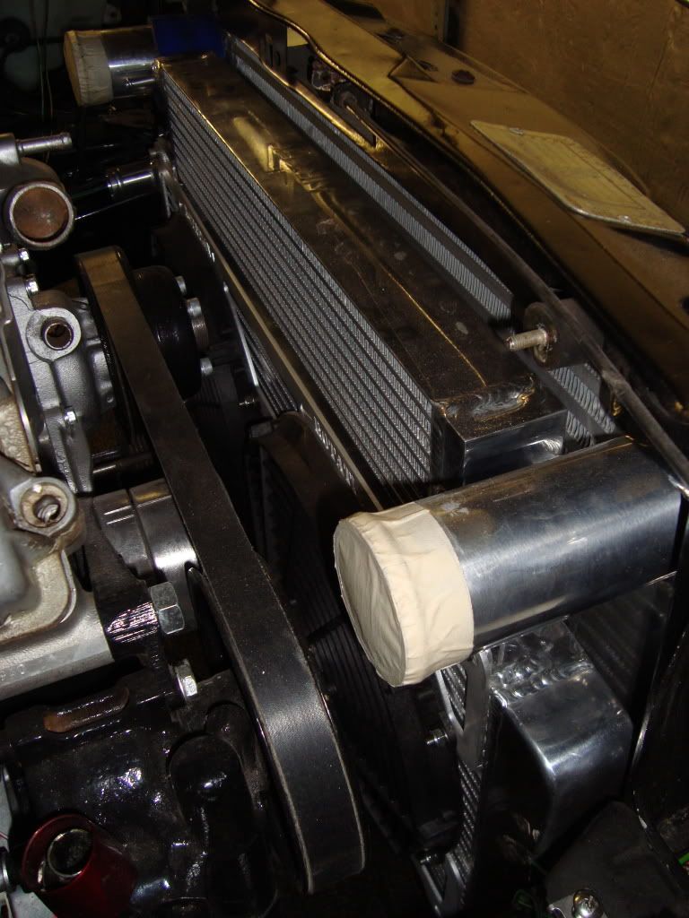

I now have all the bits for the turbo hangars, rose joints and made some brackets on the turbos and my Dad made up some bosses and so did Gray  ;) hope to do a bit more on them this week.

Hi mate thats a great bit of kit should keep every thing cool ! MM i no how good mine feels to drive yours is already stepping out and its not set up with full boost   ;D ;D, i no if mine was 2wd it would be rather tail happy , yer prob best to get it rollered fisrt and you might beable to sit in and learn more about mapping you've done a great job so far ade .

The cooler looks O.K mate, I could pick fault with it but it's more than good enough for 500bhp.
How have you done the two into one input feed to it?
